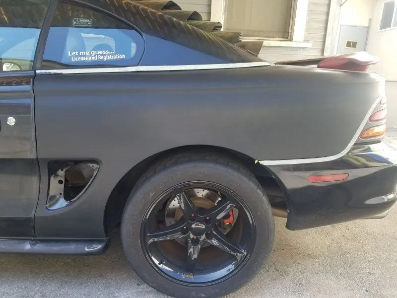

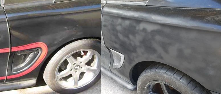

Told this story to a buddy of mine, and he said he could help me out. Putting Bondo on a car is easy - the hard part is shaping it right so it looks good. And that's what my friend taught me. Took me a long time to get the shape right, the RQP has some of the most complex curves on the car. The first photo shows the original dent, and where me and my friend got the Bondo to. It's not shaped right, it's still pretty flat and doesn't match the other side.
EDIT: My friend and I pulled out the metal as far as we could with a puller, we didn't just fill the dent in with Bondo. Even I know better than that.
I didn't get photos of the unprepped Bondo, but the second photo is of the finished shape and sanded paint. Here it's ready for final polish.

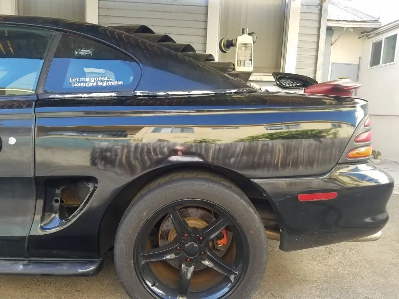

Next up is the final polished paint. The process I used has 8 steps - 5 sanding steps, and three polish steps with an orbital sander.

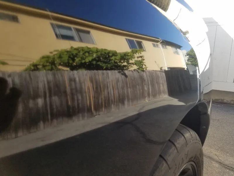

And last is a better shot of how shiny the paint is. Oh, and even better - this is $5 rattle can paint from O'Reilly. I had a lot of learning to do, and I didn't want to do that with an expensive paint. Good thing, as I made a lot of mistakes and had to repaint the panel several times. I plan on repainting the entire car with a better paint, but this will do for now.
