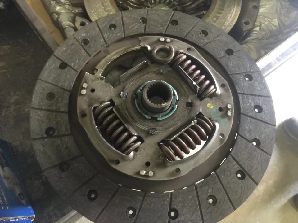

Pretty sure I blew the clutch up today; it was due after 91k of red-line racing. It basically locked me out of shifting into any gear while the car is running. I can shut it off, put it in gear, and fire it up and stay in that gear and thats it. Drove it to the tranny shop on its last leg...bits of clutch were falling out and it was smoking when I would go from stop to go....

Clutch plate blew and one of the four springs became detached.
