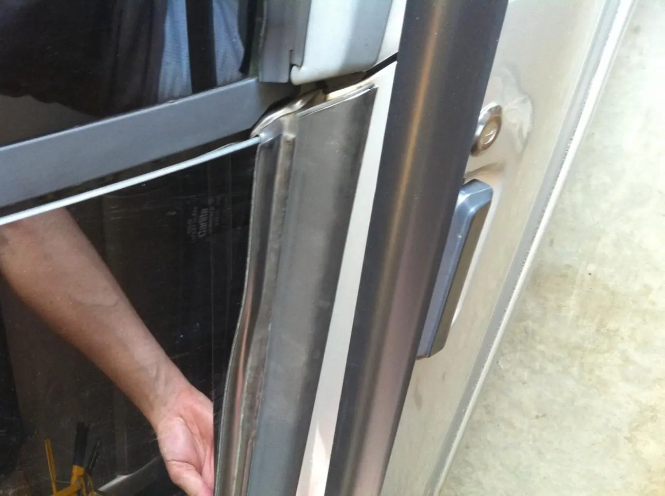

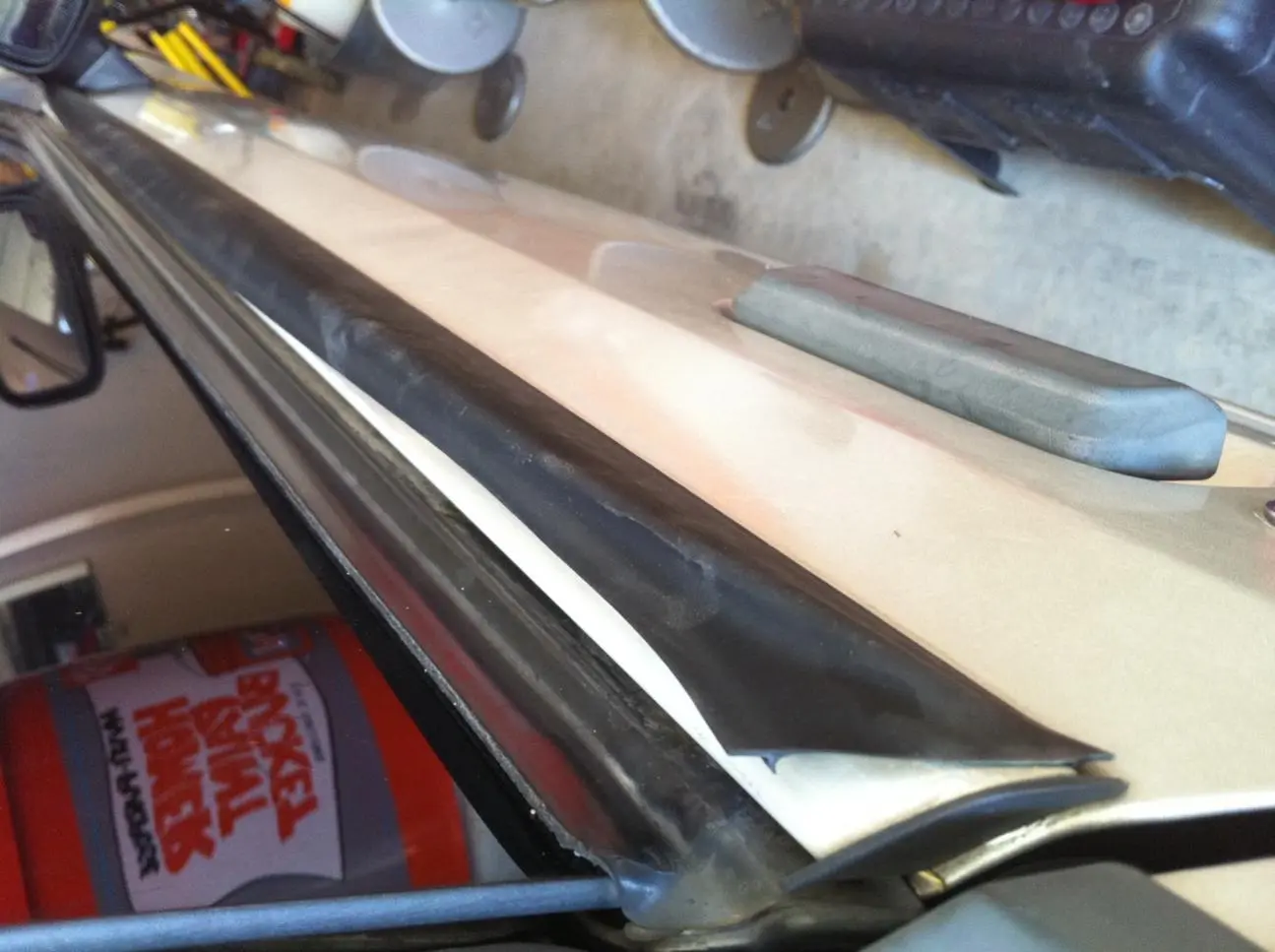

OK I finally bought the new door belt pieces and the outer dew wipe piece. Can anyone tell me how to get the door belt piece off? Its a 93 vert...

Open the door. At the rear end of the belt molding, look underneath on the inside of the door and you'll find a screw. Take out the screw and the molding will slide rearward about an inch and come off.
Yup got it... Thanks.
