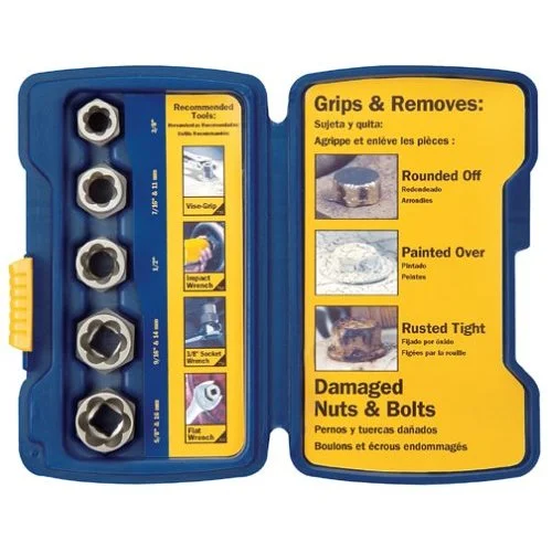

I can't remember the name, but you can get them at most auto parts stores. They are kind of like a socket with reverse threads that cut into the sides of the nut and grip it as you loosen it. I got a set at advanced auto a couple of weeks ago.
Here is the kit I used. I think it was like $25 Make sure you get the metric.
