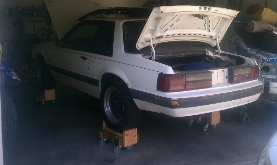

Those little car carriers are great! :nice:
Did you make those?
Thanks, Yes I did make those myself. Everything I saw for sale were poorly made and the wheels were too small and people complained about how hard it was to move the car around. I can push my car around with one hand no problem and I made them to raise my car up so I can weld my subframes in and also do other work under the car.

I kept thinking about making my own and then I thought about making them lift the car up too. I can do just about anything under the car, remove the exhaust, trans and drive shaft, cleaning etc. A lot easier during the winter when the car won't be driven I can push it up near the wall making more room and I don't have to jack it up every time I want to get under the car.
I'll do a write up this week if I get time. Each car carrier supports 1,200-1,500 lbs.
