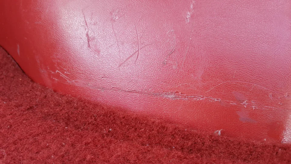

Hi, it's been a long time since I have posted anything in here. Anyway, I am wondering if anyone has successfully reconditioned the rear interior plastic hatch panels that make up the walls of the hatch area. My panels have some gauges in them, and I am wondering what the best method is to repair them. I've debated on sanding them down and painting over, filling them (not sure what to use on plastic panels) and sanding the filler down, etc. I am probably going to be selling my '87 GT with T-Tops and am trying to clean up any lose ends before I post it.

Try flexible body filler. For large holes, use some aluminum backed tape to support the body filler until it sets up and hardens.

As to the repair, you can take a piece of plastic window screen and use it as a backer, and smear it w/ a coat of bonding.
But,..
You'll never get it to match the surrounding texture of the panel, and I'd imagine it will be pretty obvious.

Lol... so bottom line, try eBay or Craiglist for your replacements.

I'm all but certain he meant gouges.
@95steedamustang has posted up some good examples of plastic panel repair in his Cobra build thread.

After you repair the gouges, you can use SEM 39853 Texture Coating before a topcoat of paint.
Thanks man! I was wondering what product to use.

if you use the sem texture,ive only seen black,but if it is,your better off spraying it light grey first,if you dont it will take so many coats to cover,the interior paint is realy thin,and red is really transparent.
Got it. I ordered the texture stuff, along with the red interior lacquer. Wasn't sure how dark it would be. Guess I need to find some grey lacquer as well. Thanks for the suggestion.
