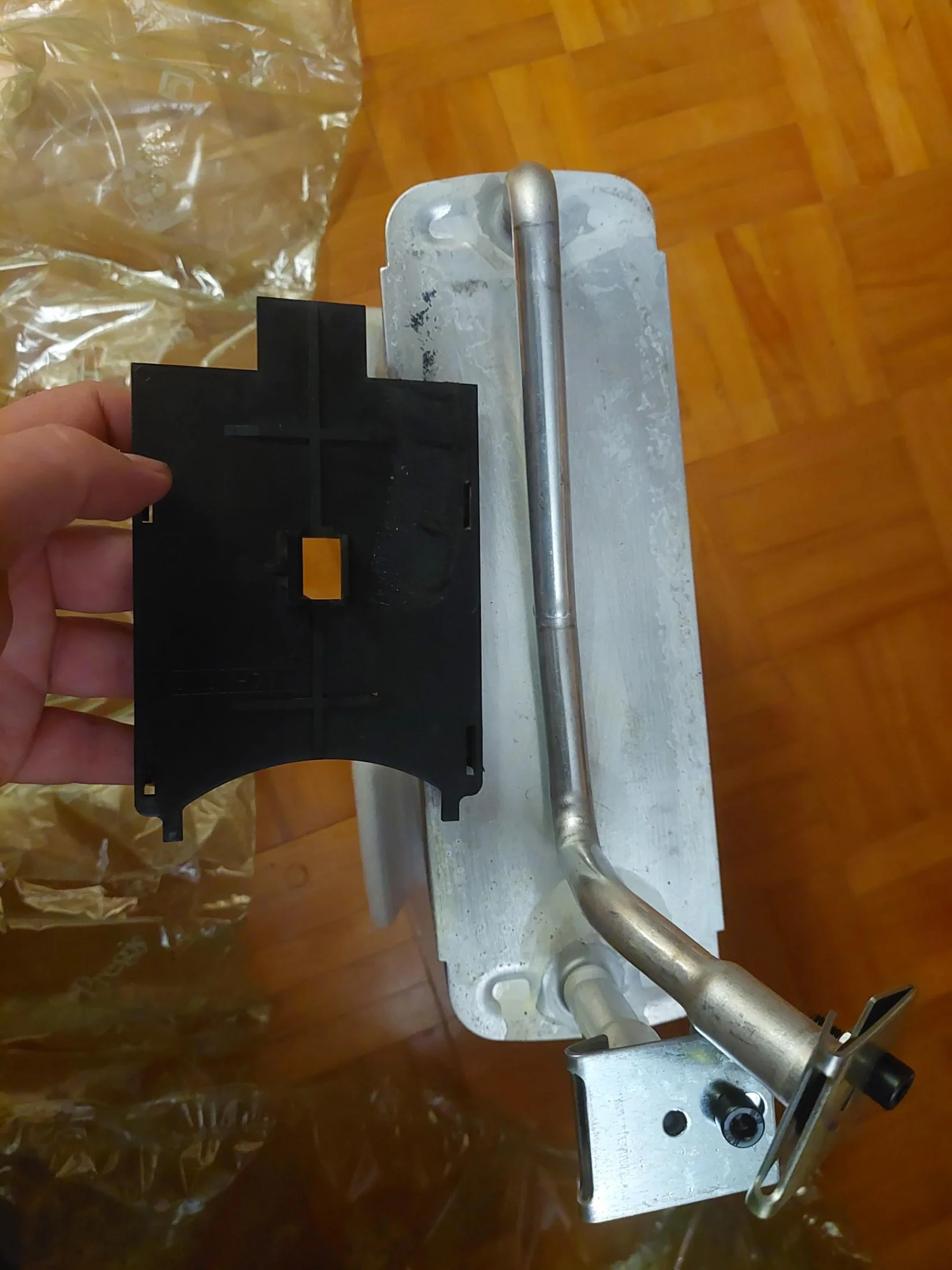

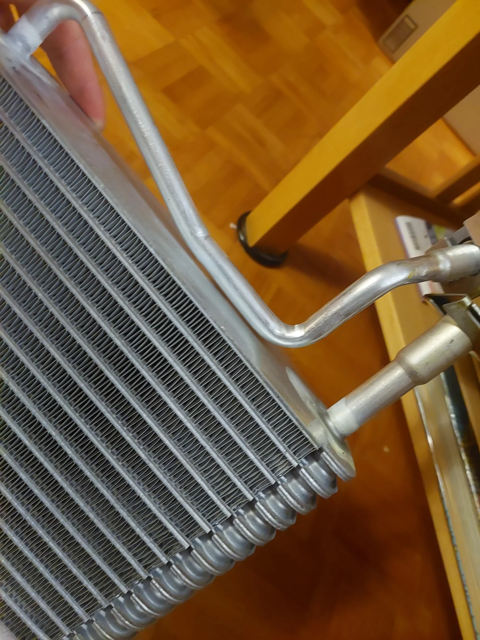

My old evap core had a thin plastic plate with prongs that clips onto the edge of the evap core and would hold the longer tube on the core in place (stop if from wiggling around and stressing the joint into the core). Pic 1 and 3 show the plastic plate from profile and top down views.

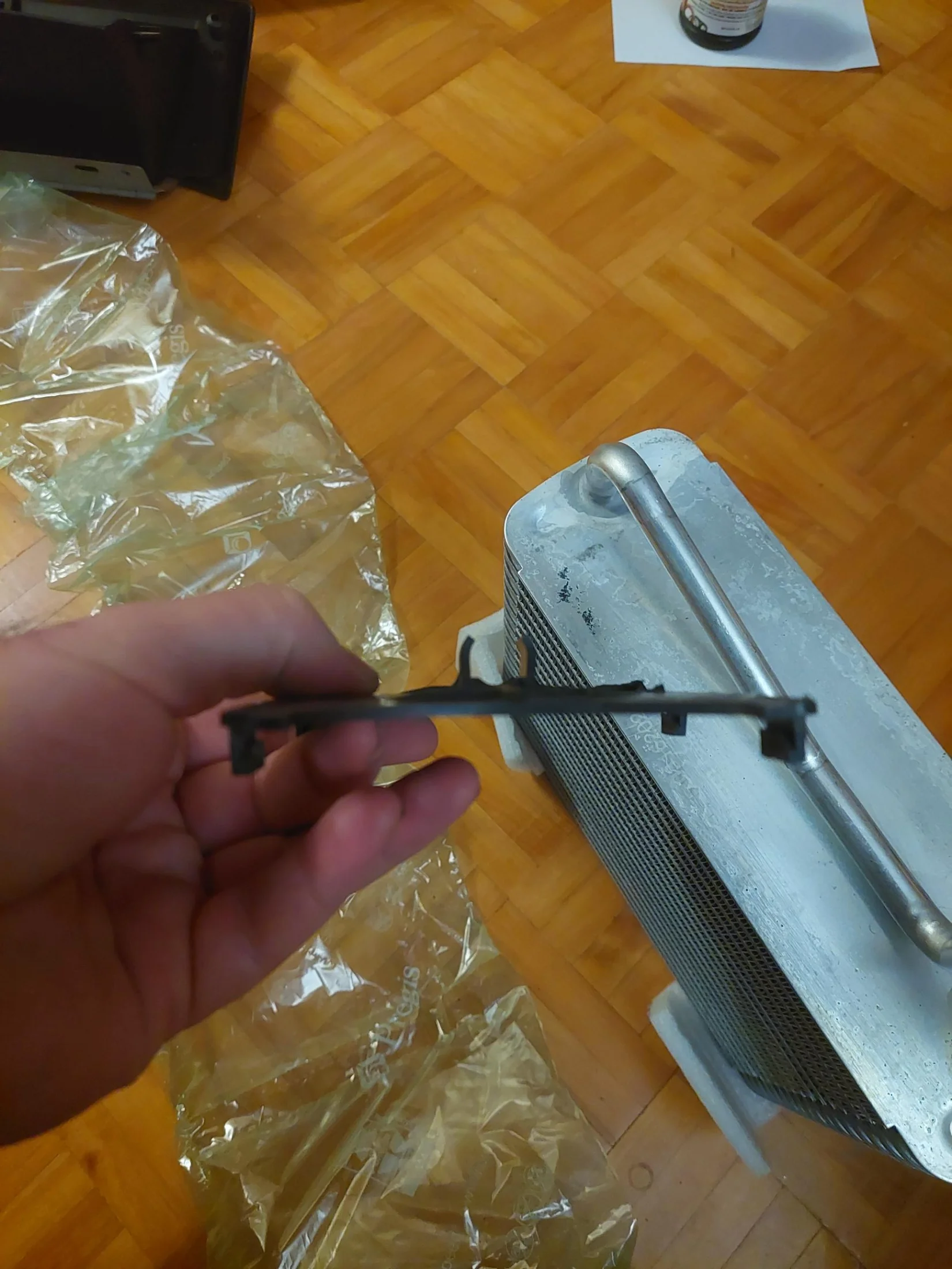

My new evap core did not come with this part. I took off the old one, but it doesn't fit well on the new one as it's too thick (the gap between the core and the tube is thinner on the new core - pic 2 shows the thin distance betwen core and tube).
I don't want to just leave the tube unsupported, as the line it connects to in the engine bay could move and stress it - am I wrong about this? Either I do a lot of sanding and dremel work to tailor this plastic to fit the new core tube - or I was wondering if I can just put some JB Weld on there to keep the tube in place. Is that a bad idea? Is there any reason that this tube is not supported better straight from the factory? the connection of this tube into the core looks like a weak point prime to be damaged by any flex.

You can politely reposition those tube to accommodate the holders.
If you need to do some re-bending, you can pick up a spring bender from a parts store. Something like this:
My only issue with the JB weld thing might be how hard that stuff is. It won't budge like the aluminum will during heat cycles.
I might try dry-fitting it into position to make sure everything lines up before immobilizing that tube. A dab of two-part epoxy would do.

Thank you - thermal expansion is exactly what I was failing to think about, which explains why the manufacturer doesn't fix the tube in place with a spot weld or epoxy. I will play with the dremel on that plastic piece and see what I can come up with.
