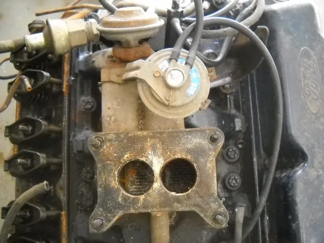

What's with me and mud? So today I went to our local Pick-n-Pull aka junkyard and I found this 1973 Ford F-Series truck with a two barrel carb and a spacer with no hoses going to it and no EGR valve. Sweet I thought maybe this spacer will work for my EGR deletion on my 76, so I pulled it off. Then I flipped the spacer over and found dirt/mud under it, what the heck I thought, man it was cracked, no good. I bought some other parts and asked if I could have this spacer for free, they said no, but reduced the price to $4.00 bucks, so I bought it just for the he11 of it since the bottom is different from the two I already have so this type would not draw exhaust gases all the time into the intake.
Can any of you identify the carb from this picture, I couldn't see a label on it?
