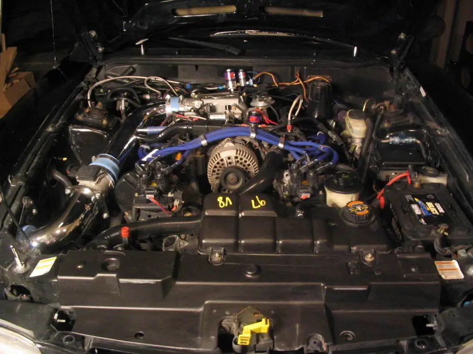

i did the whole screamin demon pack and love it. it felt a lot smoother and insured a nice strong spark for the n2o looks awesome too.
