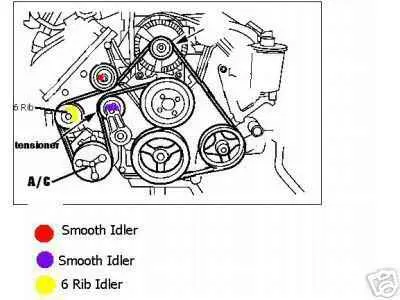

Which idler did you replace there are 3 of them 2 smooth and 1 ribbed.
The smooth one at the top closest to the alternator.

the sound is your automatic belt tensioner, the pulley is steel and the tensioner is aluminum so it wears down and begins to lightly grind causing usually a squeak or moan. I replaced mine and it fixed the noise right up
Ok, so do i remove the tensioner and then remove the pulley attached to it? Or do i have to replace the whole tensioner and pulley?
