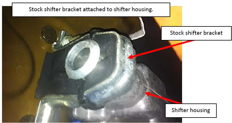

Have you considered a Barton Two Post Shifter bracket?
It kind of sounds like the behavior you're describing in the original post may be the culprit of the stock shifter bracket. (pictured below)
Yup, those are indeed zip ties you are seeing.
The Barton video can explain it better than I can:
But essentially their shifter bracket prevents the deflection that occurs which in turn "locks you out" from being able to shift into gear.
View attachment 115731 This is a pic of the stock bracket in place:

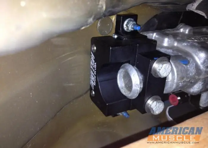

This is the Barton Two Post Bracket:
I can tell you from experience that it makes a WORLD of difference after the two post bracket is installed. (read all happy reviews on americanmuscle.com as well)
With all that being said, I urge you caution if you choose to install this based on your previous interactions with the dealerships.
Good luck!
View attachment 115727 This is a pic of the stock bracket in place:
Good luck!

I already have an MGW shifter installed. In my opinion that's the BEST option when it comes to installing an aftermarket shifter/bracket.
"Shifter" and "Bracket" are not interchangeable words. The MGW shifter does nothing to prevent the transmission from moving around underneath the car which is exactly what the Barton Shifter Bracket is designed to do.
The Barton Shifter Bracket does not replace your MGW shifter, it works in tandem with it.
I have to beg to differ with you here. The mgws rear shifter brace does limit the amount the shifter/ trans can move with respect to the body. Keep in my since both are moving with different amplitude a completely stiff piece would
Not be ideal. In my opinion the shifter bracket is not the limiting factor when it comes to the shifters compliance. That comes from the stock bracing and bushings (both of which the meg replaces).
Why would you use a Barton bracket with an MGW? The MGW includes a really nice bracket as apart of the kit.
