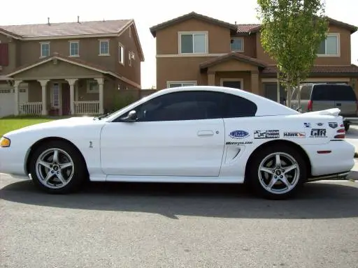

Here's a picture of how the car looks now.

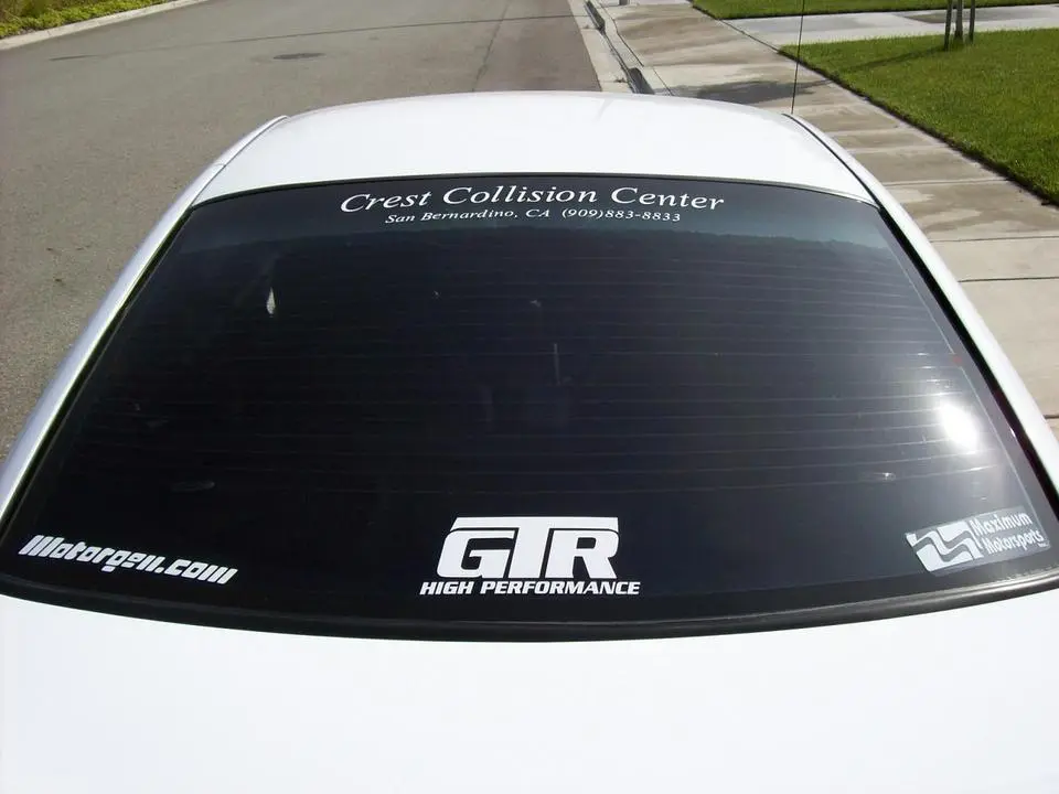

Thanks. Ya, my brother is the assistant service manager there. The car was already in to have the peeling paint on the trunk fixed before I found out that I won. Once I found out they sponsored me so I didn't have to pay for it. He also had his guys detail it and apply the sponsor's stickers. They did an excellent job matching the paint. You can't even tell that the trunk was resprayed. If anyone needs paint work give them a call at (909) 883-8833 and ask for Phil Cooper. Just tell him that you saw their work on my car. Instead of having a sticker that shows Crest Chevrolet we put Crest Collision Center.
