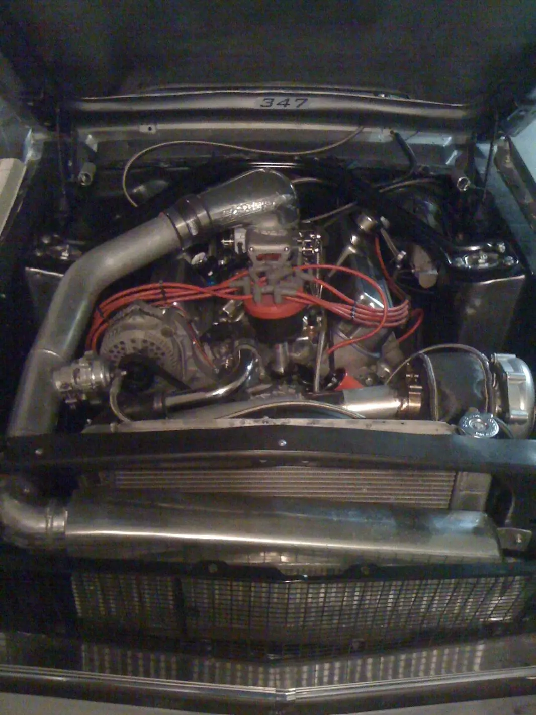

Sounds like its getting there. Have any pics?

here's one but doesnt really look any different than before.
i'm a little worried about my gas tank though. With the sump I never had issues before picking up fuel to keep 7psi but now trying to keep it at 45 is a whole different story.
I was on an incline and the car shut off cause I had 6 gallons in it and all the fuel went to the front of the tank. I'm thinking I may need to add a t fitting and also use my drain as a secondary pick point for the gas to be drawn to the pump. I would hate to stop quickly or be on a hill like this and not be able to start my car.
