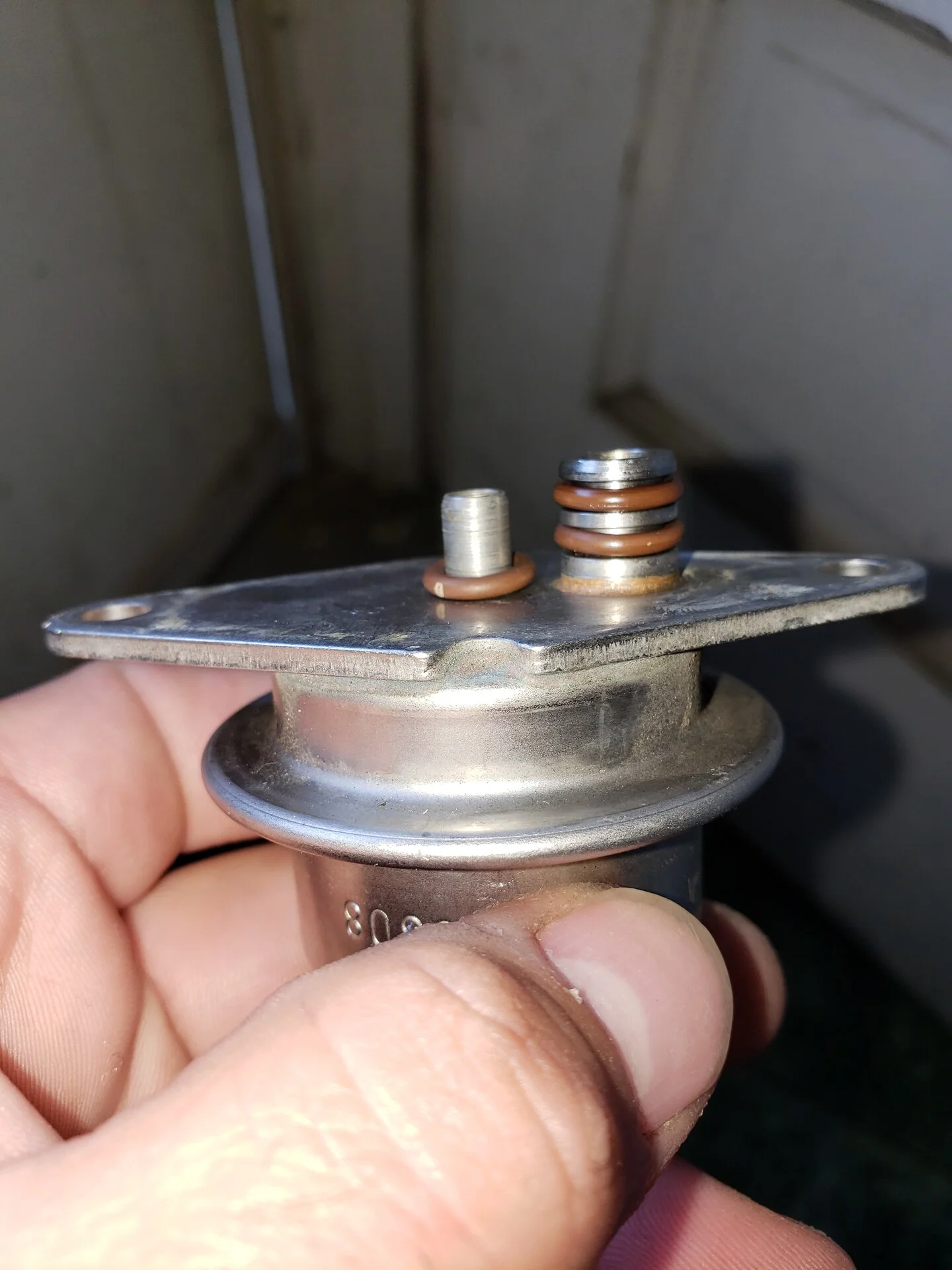

As the title states, I am searching for the o-rings for the return style fuel pressure regulator. See pictures.
Autozone and the like don't have anything specific, and the generic kits don't have anything close to the correct sizes.
Only way at this point I can see getting new ones is to buy a new fuel pressure regulator.
Problem is, I bought a new Aeromotive adjustable regulator last spring. Didn't come with o rings. So, I re used the ones on the old regulator. They leak like crazy.
Due to other things, I sidelined the project for a year.
Coming back to it, I can't find anything.
Lots of talk about others having leaks due to re using old o rings. But all threads are 10 years old, and not one mentions what to buy or where to buy it.
It's a 1998 explorer engine in a 2002 Ranger. But, the return style fuel rails are the same as the explorers, as are the regulators. I am here because I figure way more people have been into upgrading their mustangs than people on explorer forums.

All these o-rings are considerably thinner than the OEM, and my leak is coming from the return side. The thickness of the o-ring is what seals that side, not the inner and outer diameter.

Can you post up a pic of the O-rings on a tape measure so I can get a reference? I have bags and bags of O-rings, but need a size range. Some are Buna, and some Viton. I can send you some if we can figure it out. (and then post the info for future reference)
EDIT: Ok, I just looked through my selection of O-rings and do not have a large amount of smaller sizes, and most are not Viton, so I may not have the right O-rings to give you. Still, it would be helpful to post some pics of them laying on a tape measure to try and figure out the size.
Looking at the pics, they are either the 0.070" or the 0.103" thick O-rings. You would just need then either an OD or an ID and can usually figure out the correct -dash number easily.

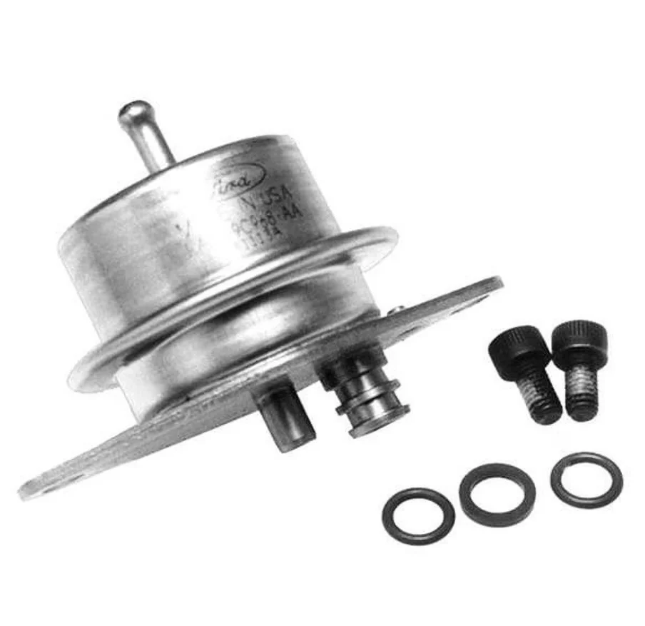

hello its the future calling...
the new regulator from ford comes with no square oring and has a "gasket" is this good enough?
This is what its supposed to be...looks like ford is cheaping out. that gasket is causing the regulator to not sit flush is my guess.
This is the 3rd part I bought from ford that sucks.
I just took the "new" regulator off and already the cheap black oring is cracked. I put the 30 year old one back on, the orings are still holding.
what a nightmare
