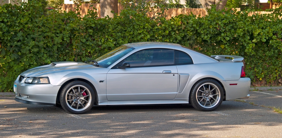

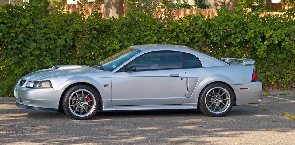

Wheel gap will look like this eventually
The front wheels are high enough that I can get over speed bumps and barely touch the cement parking blocks at the local parking lots. Thats why the front looks to be a little higher than the rears.
