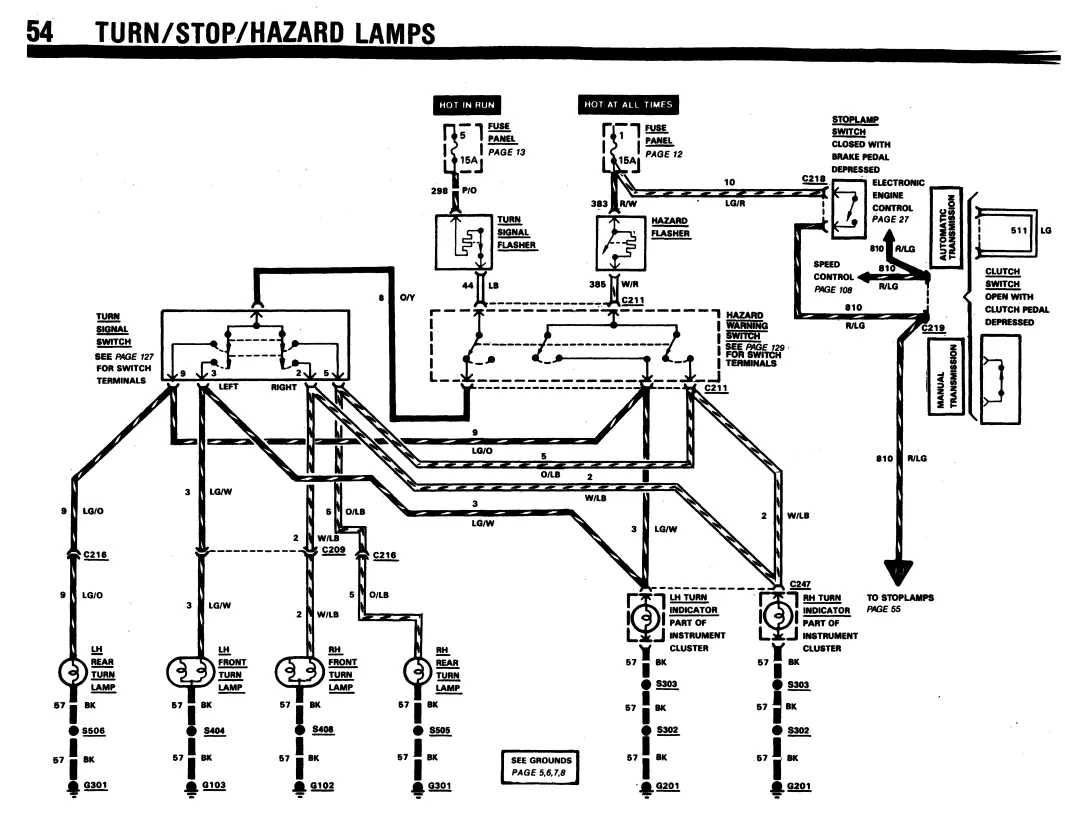

The emergency flashers and turn signals are on two different flashers. You may want to replace the flasher and see if that speeds it up as they tend to slow down with age. I believe the hazard flasher is on the back of the fuse panel and the turn signal flasher is behind the radio on the passenger side. I can access that one on my 93 from the passenger foot well.

Like said. Two different flasher relays.
