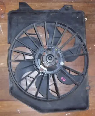

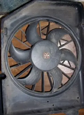

i got to the junkyard and lost my paper for the right years. i hope i got the right ones. i got an alt 130 amp from a 94 thunderbird. also a fan from a 88 3.0 taurus. i think i was right? took pics please let me know. i appreciate all your help.

I would also ask folks about a 3.0L fan - most folks use the 3.8L.
Doesnt a 94 bird have a mod motor? I dont think the mod motor alt is a 3G in the conventional sense.
Good luck.
That alt is wrong and make sure you don't p/u one just because it has 180' brackets. There are 2 diff types with 180' one has extended wider brackets, other is shorter. Get the shorter one. Stay away from the taurus alternators too, from what I've heard they actually need a custom made spacer or belt will slip. About the fan, don't think that fan you got will get enough CFM, go with any 3.8 off a contiental or taurus. Mark vii fan is better more cfm
