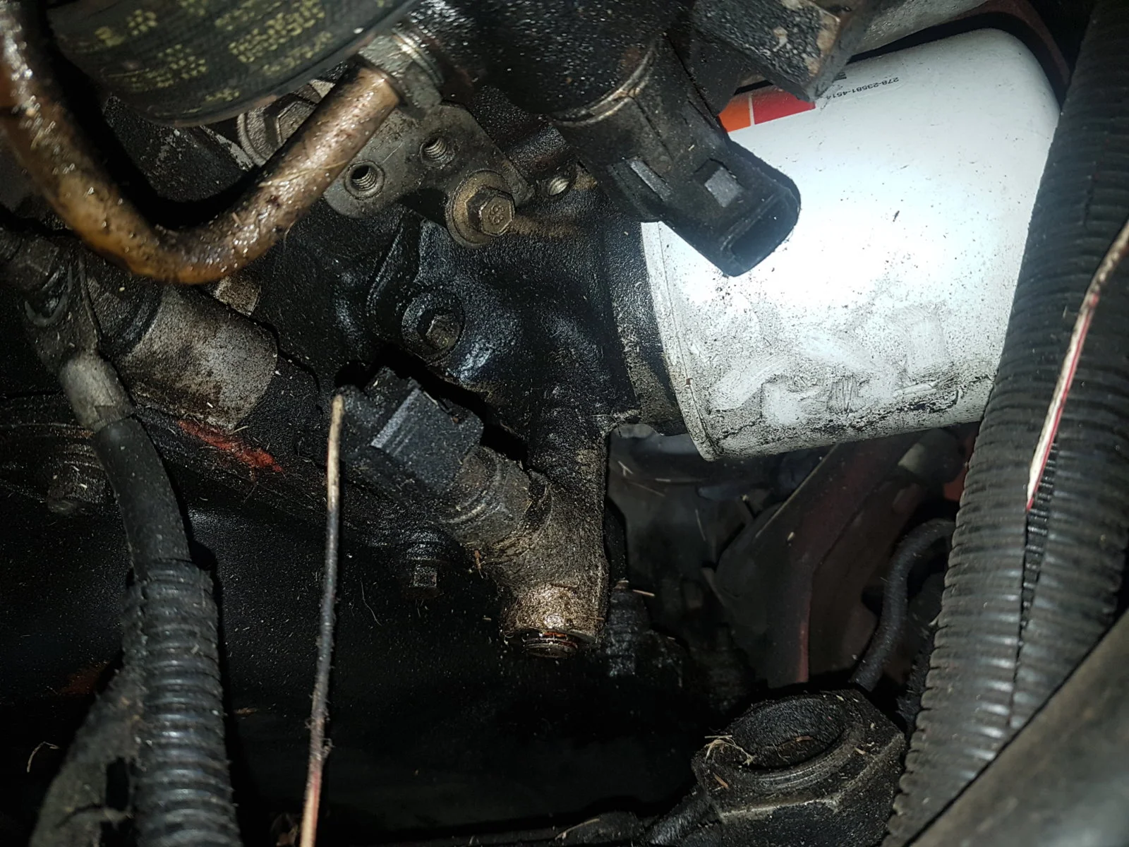

Hey guys need a little help figuring out what cable I ripped off my 2001 mustang gt. I found a harness but wanted to make sure its correct. Thanks!
Are you asking what the wire is for? If so, that is the oil pressure sender. The large black wire is for the the stater/motor ground.
The larger red wire passing under the front crank is for the starter and starter solenoid.

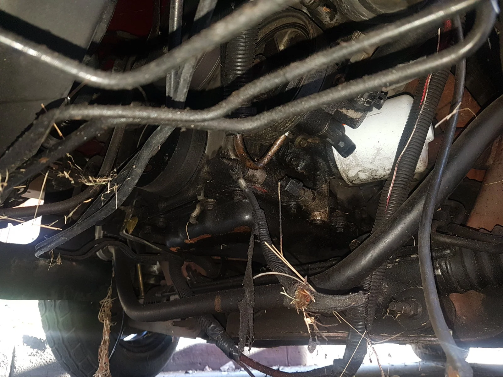

I struck something on the freeway and it pulled my bumper off and it was stuck under my car I dragged it for a while. Didn't realize it pulled my wires. I got my car towed and apparently my wires were hanging too low and they ripped them off when they took me off the road.
I noticed the leak after As well but I haven't found where it's coming from.
