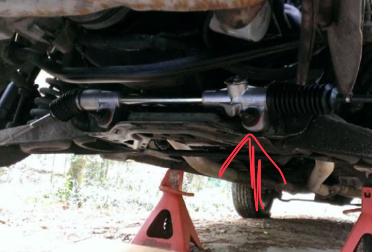

I put a quick ratio rack in my old mustang and would never go back. It's in the new project also.
The feel is things better. Changing lanes is effortless. I can't remember the ratio for sure... but I think it's 2.5 to 1.
2.5 is not the ratio on these sport racks. 2.5 is the number of steering wheel turns from lock to lock. I thinks the ratio is more like 15:1.
I've got two sport racks (2.5 turn lock to lock), one on the LX and one on the convertible. Got them both at Autozone for roughly $70 each. I have had no trouble with either one of them.
