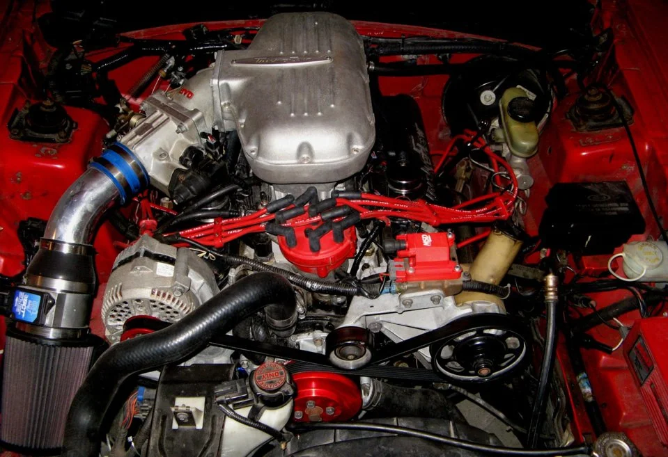

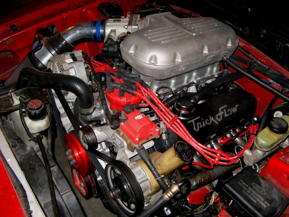

Outside of some obvious smaller parts that are heavy duty...Specs are as follows
-Motor 352 Stroker, 302 base block
-staggered tires, front p245's17 inch, rear,9275's 17 inch
-gears. 4.10
-SCT tuned,sct chip

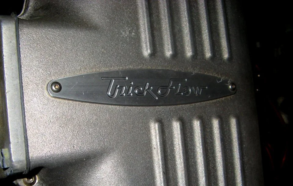

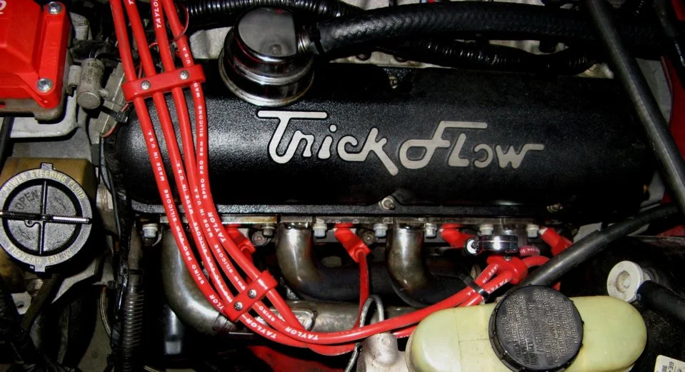

-trick flow lower and upper manifolds
-cam trick flow stage 2
-flowmaster super 40 exhaust
-BBK long tube headers
-BBK cold air intake, KN filter
-under drive pullies
-heads, AFR CNC 205cc aluminum
-3 interior gauges
-custom head light detail
-Ross racing pistons 8-5 to 1
-MSD Ignition
-fully re-enforced unibody
-44 lb injectors

Nice except for 2 things:
1.) The air filter in the engine compartment is a big no-no. It sucks up hot air from the radiator and the fan wash can do strange things to the air flow through the MAF. It is also prone to causing idle problems.
2.) Unless you are planning on pressurized induction, the upper intake manifold isn't the most optimum choice. The short runners move the torque band way up high in the RPM range which makes for a lot less street and low speed performance.

And the cai is to small IMO (not a big deal but...) 8.5:1 really really needs some forced induction. I don't like that cam either. Not to rip on his combo. It looks like a nice car.

It's good to know. Good points, but no problems so far. Rips well.
