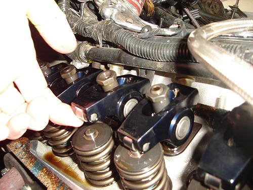

86bluecobra said:
what i did to fix the ticking was put a very annoyingly loud exhaust system on my car. now i can't hear the tick lol. 351w bark
lol. I had the same thing after I raced a friend's notch. I got on it hard through second gear and after I let off there was this ticking sound. It sounded too metallic to be a header gasket. I got it home and let it sit for a couple days. So I changed the passenger side header gasket because I had looose header bolts on both heads.
It was ok the next morning on my way to school. After class I start it up and the tick was back and louder. I start driving home and once I get on the freeway it gets even louder. Finally it's so loud It sounds like metal parts are clanging around inside my engine so I pulled over. After sitting on the side of the freeway for three hours waiting for a tow truck I get it home and open up the valve covers...
The adjuster was almost completely backed off!! Well I re-adjusted all rockers TWICE just to be safe. Ticking gone.
BTW, the book I used for reference mentioned that for stud mount rockers to go 1/2 to 1 full turn on the adjuster after pushrod snugs up, then snug alan nut, but to use the adjuster nut to tighen it down while holding alan wrench. When I did mine during HCI install, I only tightened alan set screw and that would explain how they got loose.
Good luck.

I have the same problem, and i have the cobra (crane cams) alum roller ones. We pulled the valve cover off backed them off then retorqued them and still the same but for you there 91lxttrim i think you had a problem? peace

yea it just sucks because then you dont know when they are about to fall the fck off like 91lxtrims haha. I guess its not a bad idea to pop off the covers every once and a while and adjust the valves.
Good luck.
the same exact thing happend to me at the track
