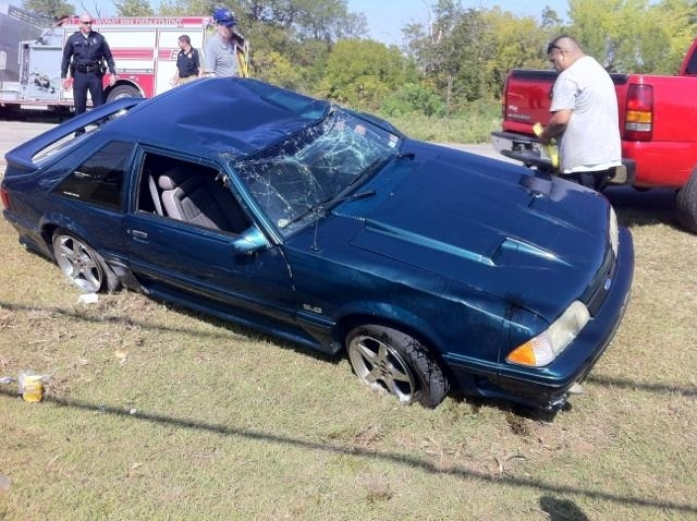

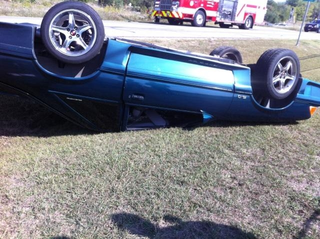

So my buddy was out messing around in his super clean 91' Mustang GT yesterday, got it too sideways, went into a ditch and rolled the car on its roof. :nonono:
The motor was still running for maybe a minute upside down until my buddy was able to get himself unpinned & out from the car, and then he turned the motor off.
The car sat upside down for maybe 30 minutes before we were able to get the car flipped back on 4 wheels, and then we noticed oil was pouring out from under the car. (no sure from where)
