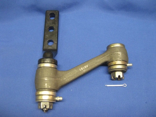

Here's a bit more info for 67ers like me....
I confirmed that the Moog K8158 is for PS cars.
Moog makes one similar for manual steering cars like mine, K8161.
Here's some pics below, as compared with my original.

Okay, here's the dealio....
the Manual Steering K8161 and the Power Steering K8158 appear at first to be identical.
Turns out that the drag link end is the difference. The K8161 sleeve has a smaller i.d. than the K8158. The K8158 would have been very loose on my car.
There is another difference though....
The sleeve in the drag link end is quite a bit longer on the K8158 than the K8161.
I'm very pleased with this new M2 design and expect it to work very well.
Thanks for everybodys help.
Joe
