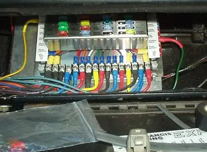

I just wired my 67 with a ron francis express panel and can only say good things about it.Its very easy to work with and tech support was always on line when needed.regards javed

I have used Ron Francis and Painless. The only issue I had with Ron Francis is that you have to make ALL the connections to the fuse block. Look at the above posted picture. This can make for a loose or a disconnected wire. Painless's wires are directly conneted to the box. A much stonger and far more secure setup.

ron francis was the first to sell complete wiring kits to the public, with the wires marked as to where they go. as stated you have to run the wiring from the fuse panel to the load, and that does require that you make extra connections. and it does allow for extra locations for possible problems as well. but the ron francis kits are also very good quality and i dont hesitate i recommending them. just be aware that you will be doing more work than with the ez wire or painless kits.
