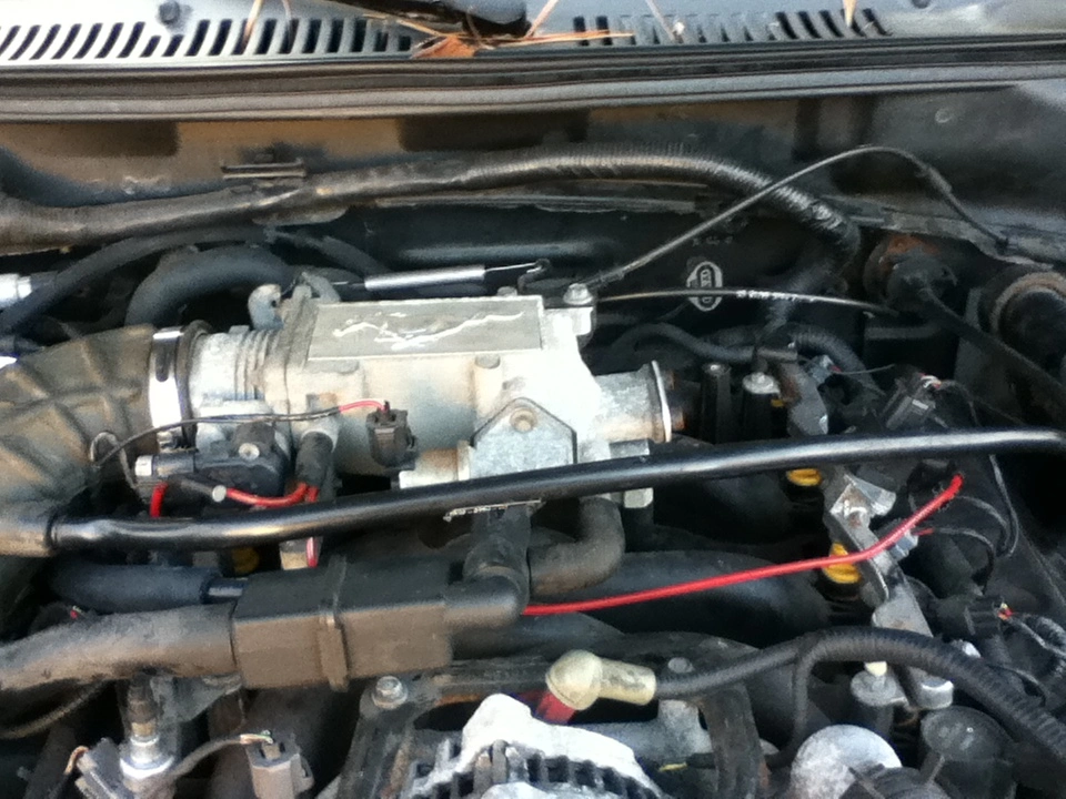

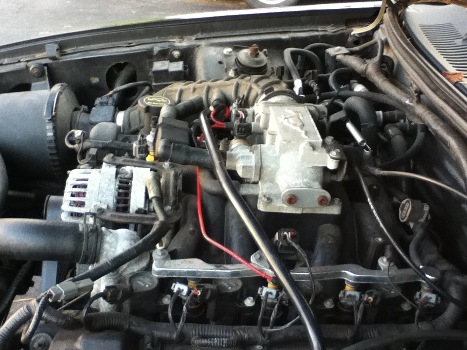

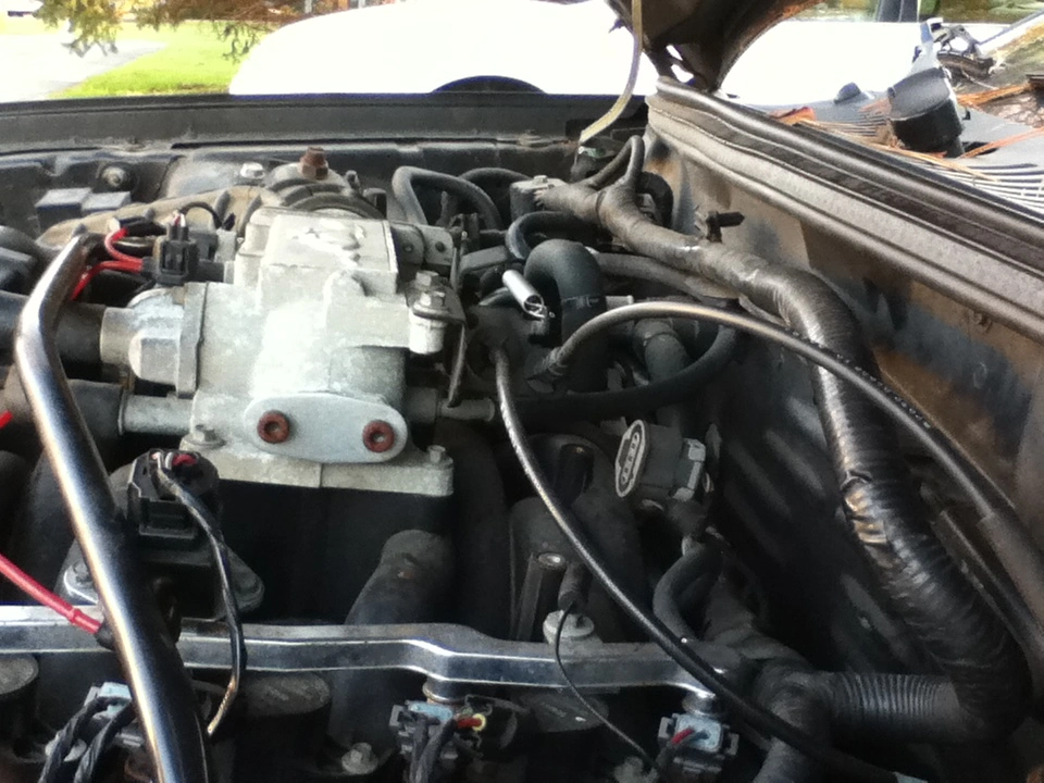

You know, I didn't even think about checking the other end. Don't think any lines are cracked either. This is what I got. Ignore the dirt it has sat for almost a year ( last winter, months of travel and no inspection haha).
I'm hoping I just did something stupid and it's a simple "You didn't plug in X to Y, idiot!"
