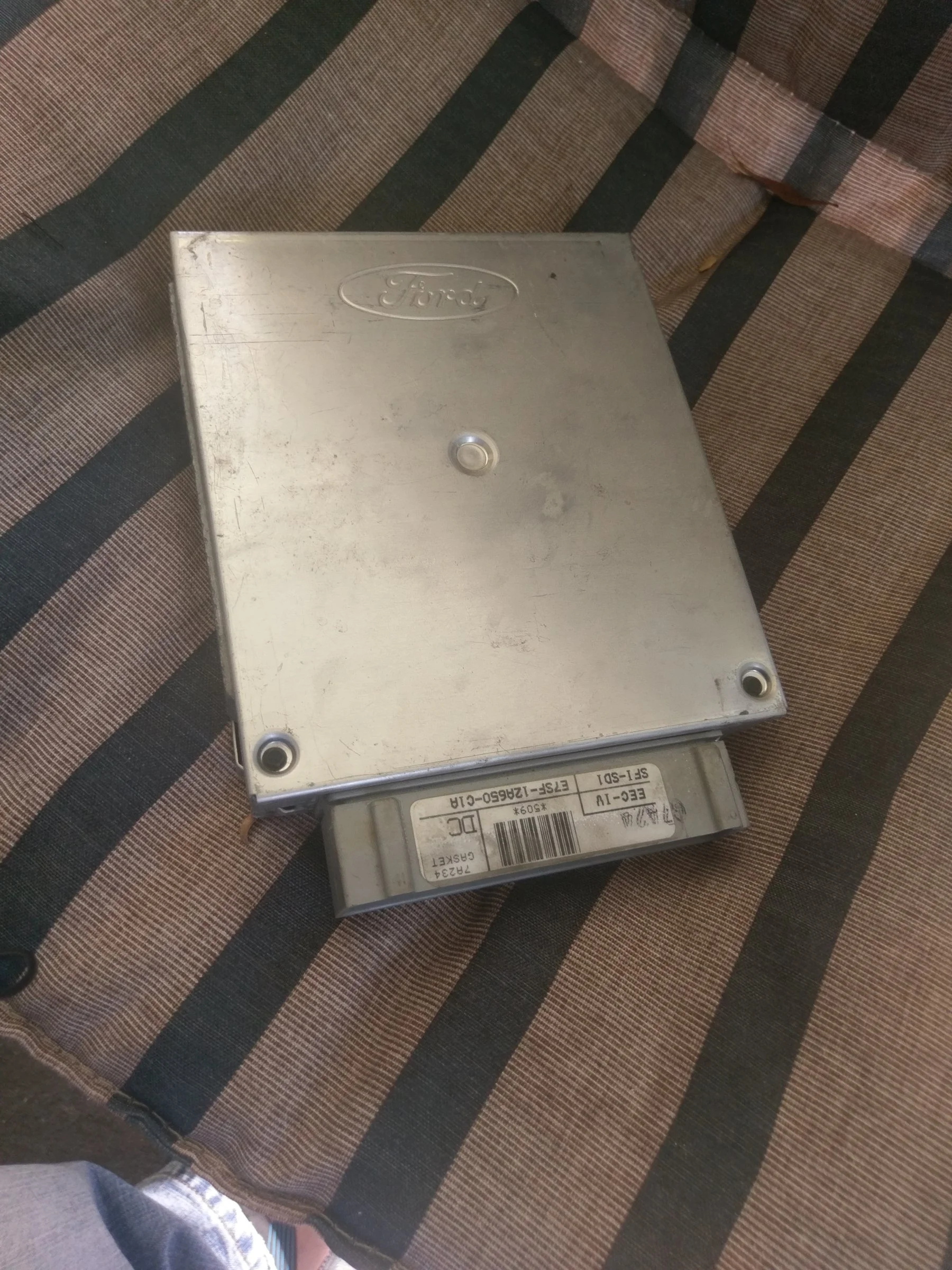

Bigger isn't really the word, but the non ho ecu like said before utilizes a different firing order and is set up for 14lb injectors, not the 19lb units you are running. I'm surprised the car even ran at all. I may have an SD computer kicking around. If I can find it it's yours for the price of shipping. It worked when I pulled it 7 years ago, but I offer no promises on it.
Ok got the the pcm in thank you stykthyn haven't had enough time to really see what's going on but it definitely idles better but now it feels like it's misfiring or bad injectors so now I'll look for a set of injectors and see how that goes
Glad to see the ecu helped out.
