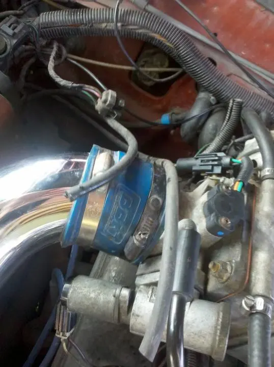

Is there anything anyone can think of that would be causing this problem? Vaccum hose hooked up into the intake wrong? Maybe a bad fuel pressure regulator, anything?
Also the stock H Pipe is still on the car, but the smog pump is not hooked up and the air line has been welded off on the H-pipe... dont know if that could cause any running rich issues either

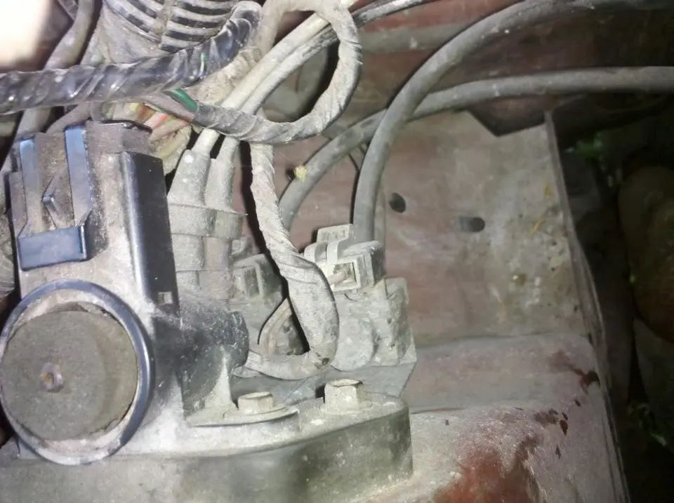

So after looking around a bit more, i found these! 2 vaccum hoses that connect to nothing, also there is a power plug that is just there, not plugged into anything, nor do i see anything to plug it into
coming from here
It looks like it is where my EGR regulator is, 2 hoses go off and connect, then these 2 are just left open? I have no more charchol box which is what i think they connect to, i really cant see any other place they would go...
Should i plug them if my smog pump is all plugged and egr blocked? Could this be causing the problems? i dont want to plug them, start it, and have somthing go horibally wrong...
That looks like the low pressure plug for the a/c.. That wont hurt anything.. With the cats not working it will smell like gas.. My clothes stick after I drive my car.. If your smog pump isn't hooked up that could clog your cats up if I'm not mistaken..
