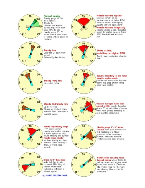

It sound like a vacuum leak. My recent experience with this same issue was bad intake gaskets. I verified it by spraying carb cleaner around and the idle increased when I hit the leaks.
Spray around your carb and gaskets, and see if your rpm goes up.
If you have a vacuum gauge you could use this.
thats the best image i have of it. Good luck.
