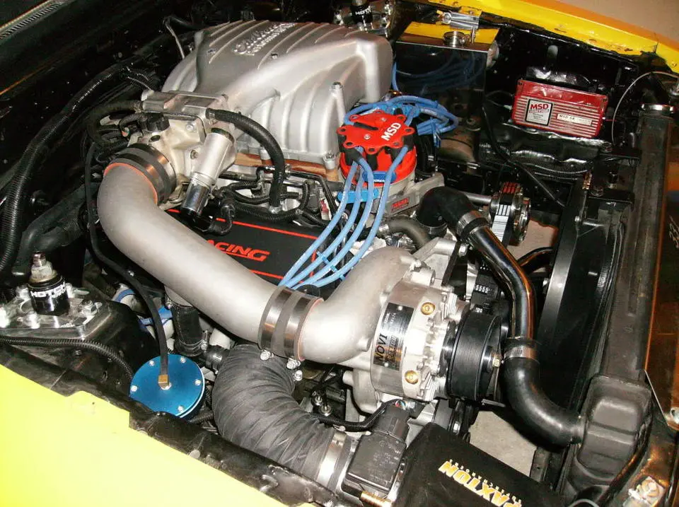

I have a 331. Just bolted on a Paxton SL but it's too cold to start the car here. I just ordered some 42lbs injectors and a 80mm mass air and need to bolt on an Anderson power pipe.
The blower was super easy to install. I'm hoping to hit 400 - 450 at the wheels with a 11.5-11.9 1/4 mile time. Ran a 12.24 with just the 331.

I will be putting in a 255lph pump, 42lb injetcors, Pro-M 80mm mass air and Anderson power pipe when it warms up. A new pump is worth 80 -120 bucks depending where you buy it. I have 30lbs injectors and a 75mm right now but I don't think it will be enough. I was also running a 155lph with just the 331. No rev limiter with it, bought a MSD 6AL but got a 6A instead so I'll have to make due without one for now.
Installing it was easy and I believe the average Joe with a some mechanical skill can install it. I paid 1700 bucks for mine.
My car is drivin on weekends for 5-6 months and will be seeing the track 3-4 times. Reliable - yes. As a daily driver - not so sure.

Where did you get it for $1700??! Im thinking about getting it and throwing it on my mostly stock 93 gt. Then building a 331 on the side, which may take a few months to complete. In the pictures- is that what the intake tube looks like?
Do I need a Bypass valve/blow off vlave? If so, which one? I can throw the standard kit on a stock 5.0 out of the box right? Then for the 331 with the usual bolts ons, etc I will def need bigger injectors,etc.
Brand new off of Ebay. I've made 222 transactions so far and only had a problem 3 times but all were resolved.
Yes that's what the intake tube looks like = puke. I'm taking it back off to put on an Anderson power pipe, which should hopefully pick up some boost and look badass too. I think all the paxton / votech kits like this one come with it. It's a plastic 90* elbow with the flex tubing, and maf housing.
It comes with the standard bosch blow off valve and the whole kit should be ready to bolt on out of the box, ready for a stock 5.0. With the 331 you will defintely need bigger injectors, maf, pump etc.
I've done a lot of research on Stangnet and other sites and according to everyone else's experience my 30lbs won't cut it so I bought some 42's and an 80mm blower mass air.
You might be surprises with how the car is with just the blower and may not want to build the 331. You may want to just add the supporting mods to it. It gets VERY expensive doing both!! Now I need a tune = more money!
