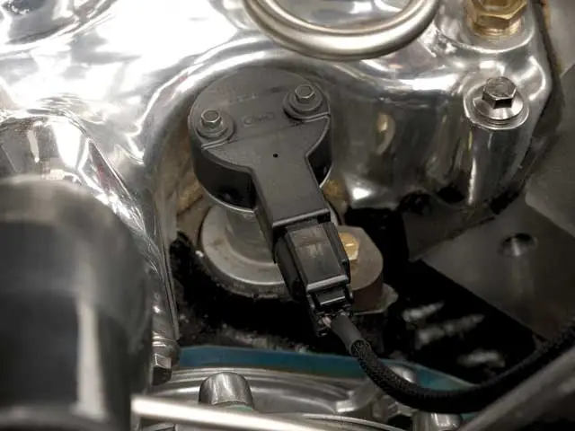

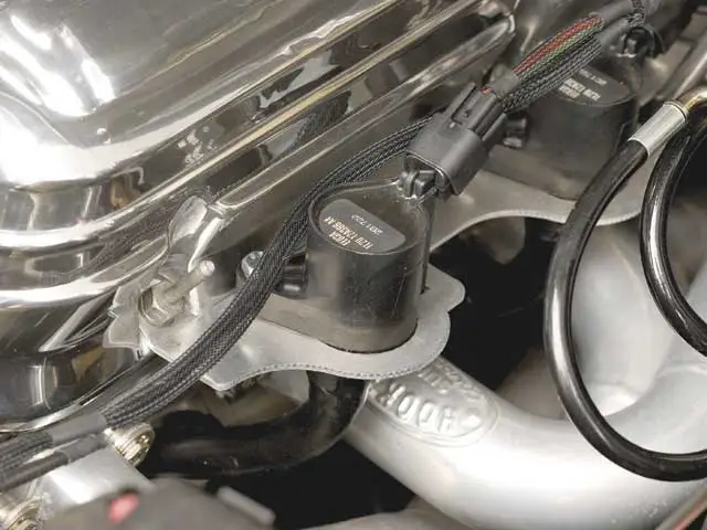

NICE FIND!!!!
Here's some pics I pulled:
Looks like they've got some real heavy duty insulation on them but undoubtedly it works!
and i assume this is the trigger....I wonder where this would be sourced from? :
that is some awesome engineering/installation!!!

Joe's setup is similar to mine but also different.. He has a 302 based engine.. Mine is a 351W based. Now the what you call the trigger is actually a cam sync off an Explorer. His setup is using a 99+ EEC where i'm using the stock 95 GT Auto Computer and a waste spark setup compared to his firing one at a time when mine fires 2. I had to make my Cam sync from a V6 cam sync shaft and install it in a Explorer housing. He has more money than eye so he got his completed quicker then me
I'm wanting to convert mine to what his is this winter. Only reason why I went the way I did was because I didn't have anything to tune it with at the time. Now that I do it will be going OBD2. I'm just wanting to see the S351 96+ setup for the trigger because i'm curious to see what they did.
