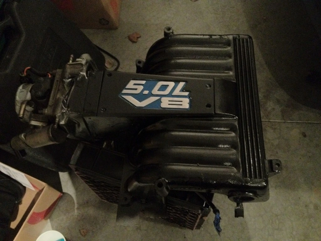

Ended up using The aircraft stripper... Talk about a pain, I was pretty much high from being around it! I also didn't open my garage door.
I got it all painted and the plate with the 5.0 L V8 polished, and the back ground blue. I am hoping it turned out good

The plate turned out great! Still waiting on the intake to dry.
