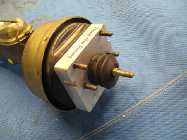

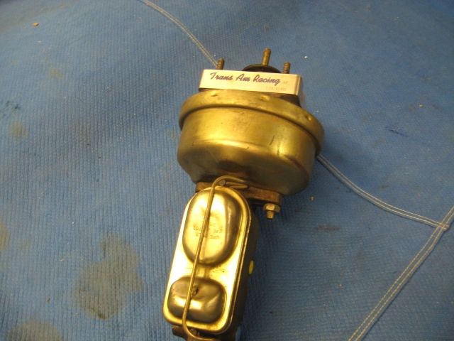

Much agree with GT. If just so happens when I switched from a C4 to a T5, I could no longer use my 67 MC disc/drum w/booster. It is for sale, PM, if interested.
