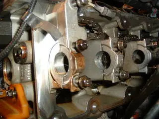

We have a 2003 supercharged 4.6l with 2500 miles on a remanufacture from one of a so called reputable builder. Had some issues with external sealing and while correcting those isseue discovered that the right(passenger side) head had developed scoring on both cams and to the castings as well. I am courious why I see none of these symptoms on the left. Also if any one has a clue as to what kind of gremlin is really in this engine I would really appriciate a response. The scoring is on both the journals and the lobes,the intake cam shows signs of overheating as well.Wil try to upload pics asap!!

Where is the scoring?
Likely cause for scoring

I should almost use MS paint to circle it but just start looking at the area that obviously got hot then look to see what it's missing as opposed to the other areas like it. It was almost enough for me to stop buying Fords all togather, MOBLE 1 Baby 100,000 miles like that. and the only reason I found it was I was getting better cams installed.

there is no bearings on the cam journals. so if scoring happens it can score the hea ditself.
I understand that. But I would call it "journal scoring" rather than "head scoring". I had visions of some unusual scoring either inside a combustion chamber, or else on top of the head, as opposed to a camshaft journal.
