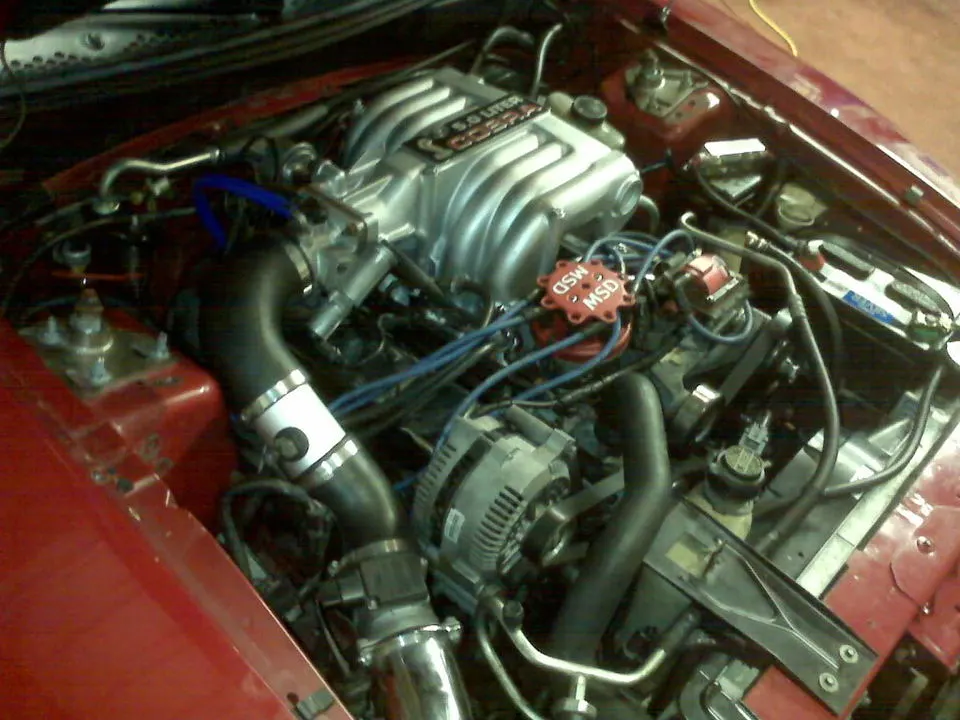

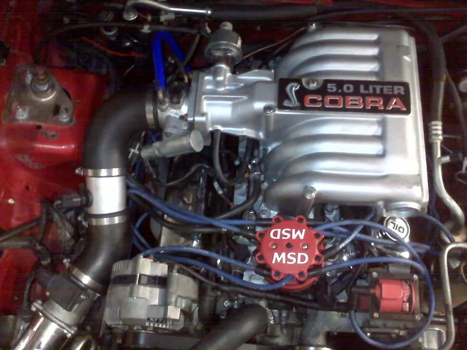

I did it and I'm glad you convinced me to! A lot cleaner and nicer looking this way!
Still have a little cleaning up to do. Installing my MSD 6AL tomorrow.
Where did you get the elbow and intake pieces from?
Intakehoses.com provided the 90degree and 45degree rubber elbows and the 3inch diameter aluminum tubing 6 inches long total. The part before the MAF is from a store bought kit by MAC. I didn't want to relocate the K&N from the fenderwell to the engine bay. Its anchored down and doesn't move at all. It worked out pretty well I think.
