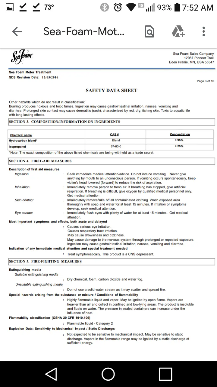

I gave up on that stuff after it ate my fuel pump
Seafoam couldn't have done that, it's not chemically capable of it. It's naptha and isopropyl alcohol.
Your pump more than likely failed over time due to the modern ethanol-enriched fuels our government has forced upon us. The ethanol is corrosive, and eats fuel pumps and other fuel system components over time when they're not designed for it.
I think Xylene is in there. That will eat just about anything. I put anti ethanol / w cleaner in my gas??? Im going on my forth fuel pump on my Tacoma. Out of post question ??? Is a Walbro 225 the same fit as a regular electronic fuel pump?
No Xylene.
