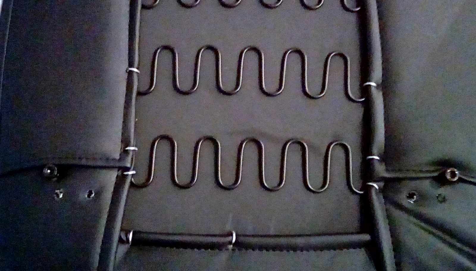

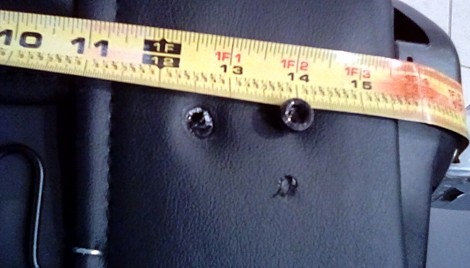

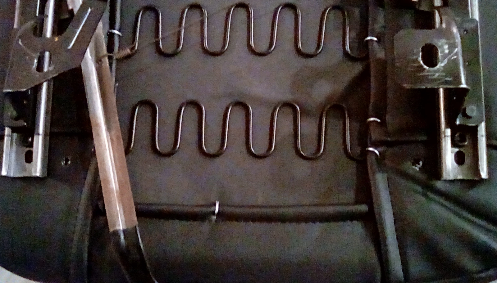

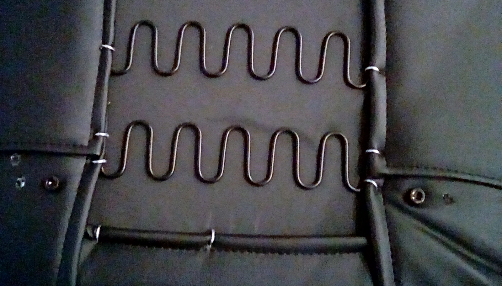

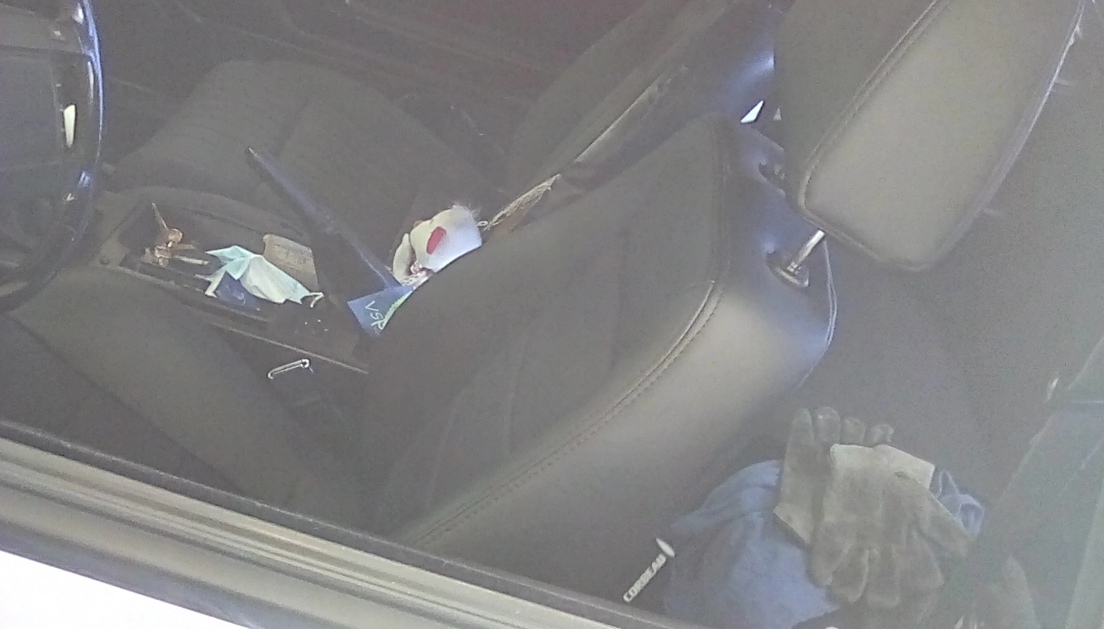

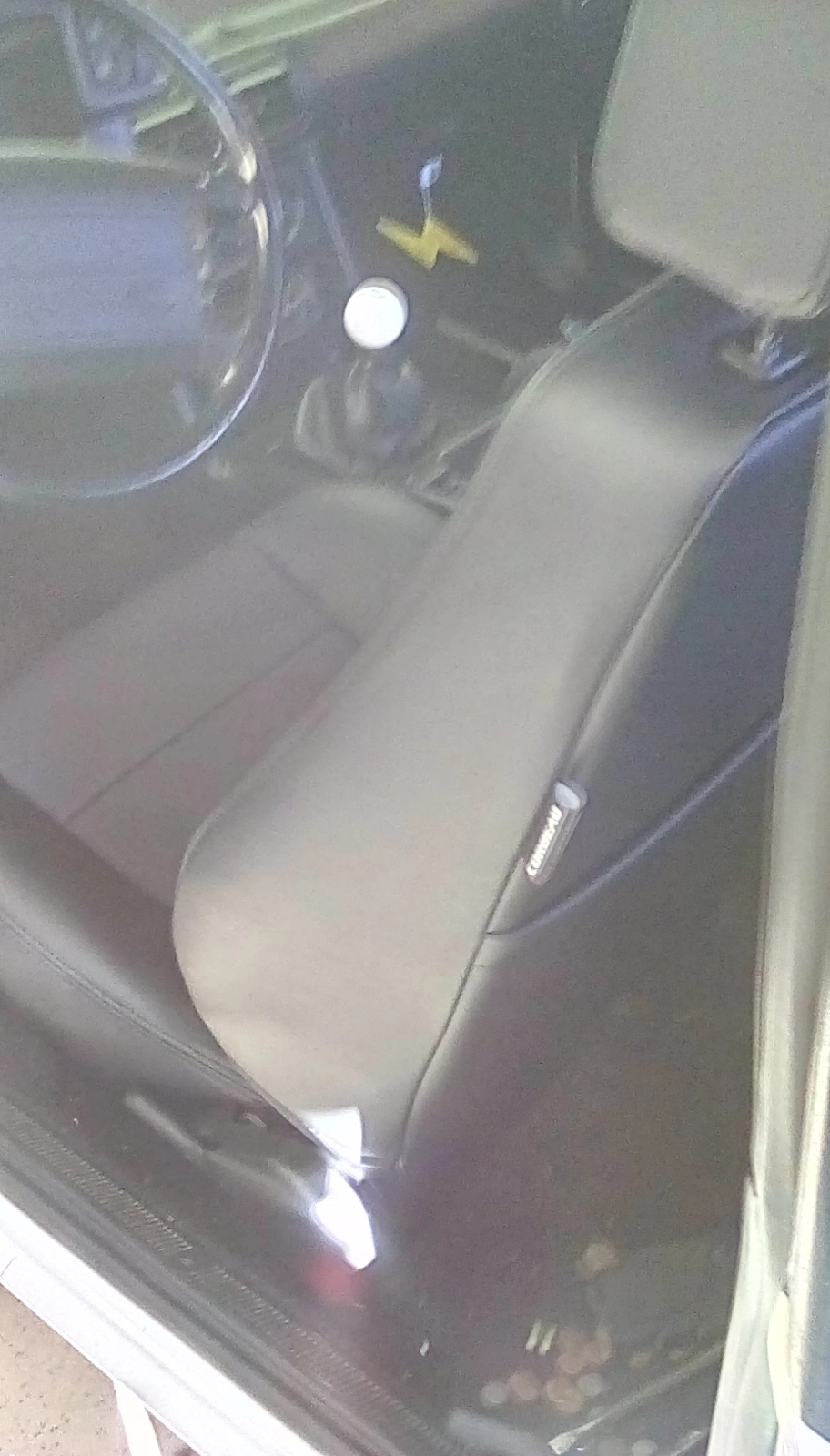

Well well well what the hell. I checked the underside of the corbeau seats and they have multiple holes to use. I did some measuring and my stock brackets are 14 inches center to center. One set of holes in new seats are 14 inches apart, yahoo.Not so fast. That's the width the length is 14 and 3/4 inches and you guess it non of the holes match.Sooooooo, I measured and drilled a new hole in my stock brackets 1and1/2 inches from the front and that worked perfect.
