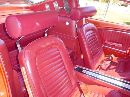

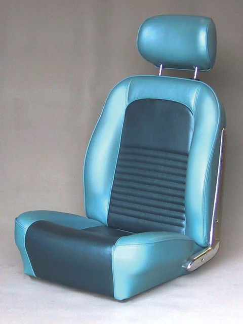

The headrest kit has two posts, like the 68, although the pad itself is sculpted, not so plain as the optional 68. I know where there are 2 or 3 68 headrest seats, and yeah, the price is usually just silly.
There was a Ford add-on headrest, which amazingly is being reproduced. I say amazing, because it wasn't all that nice.
Repro of original Ford:
TMI headrest:
