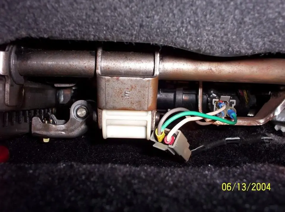

I'm getting ready to bolt some 04 seats into my 93 GT.
I was wondering if anyone knew the part number of the female end of the connector below.
Also, are the bottom posts power and the top left ground (top right not used)?
Just wire it as shown in the picture above. All you need is a selection of electical connectors, some wire and, if you really want to do it up, some heat shrink tubing. It works great.
+1, I wired up my '04 cobra seats using the image above. You'll need two 12V power jumper wires and one ground jumper wire. Follow the image S&B posted and you'll be fine.
LOL! As much as my wiring picture above has been used, I should have at least made it a bit cleaner looking of an install! I used the round bullet connectors on the seat side, and spade connectors on the harness side, all left over from other wiring jobs (including the wire!). Still works great.
