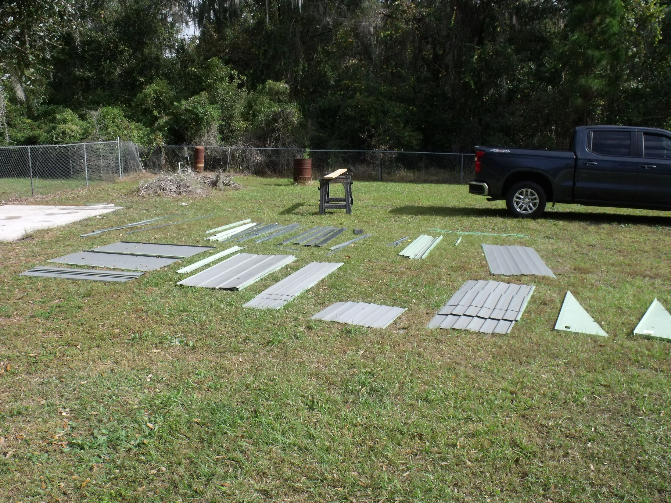

Projects like assembling my new storage shed

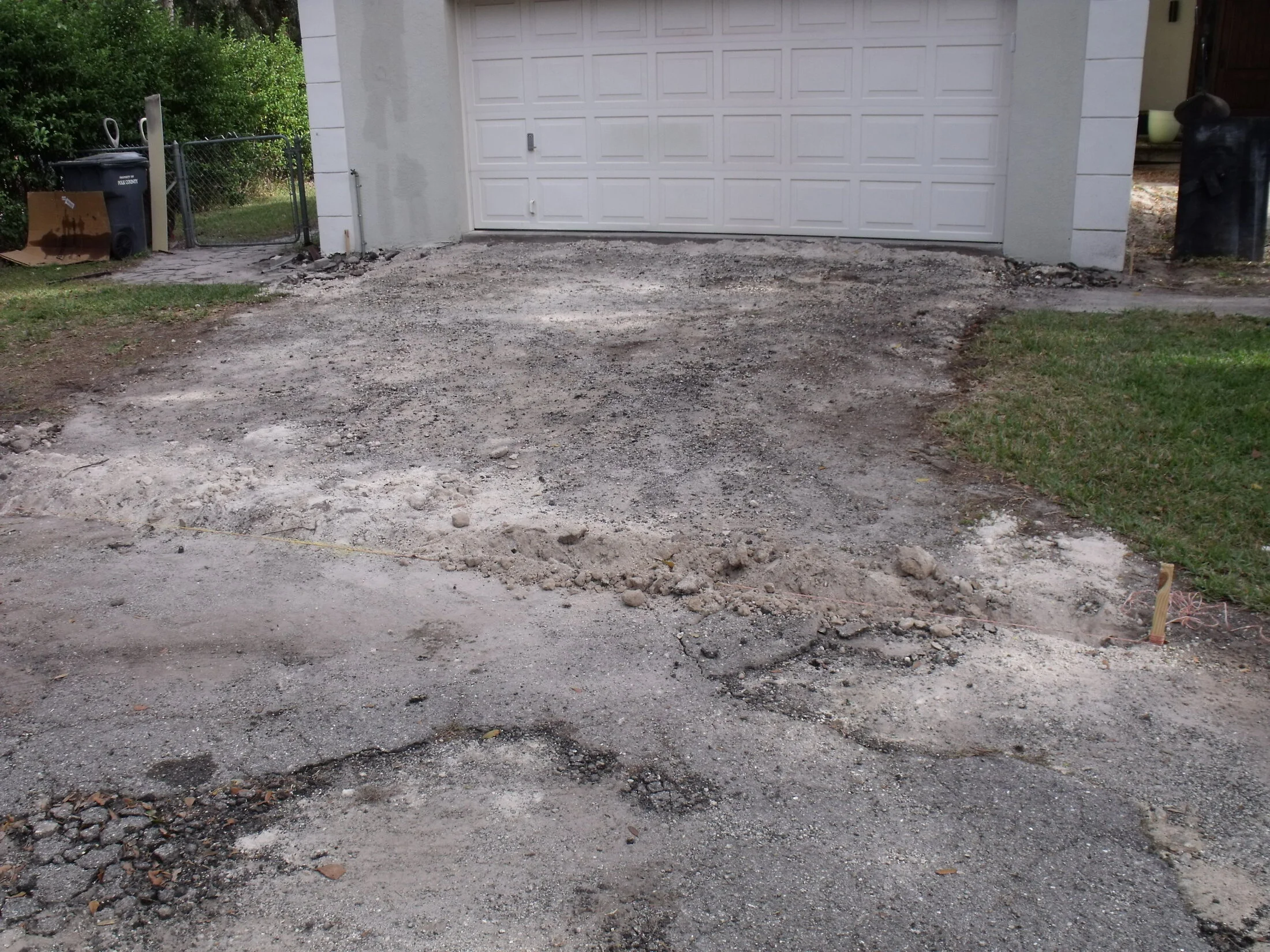

finish prepping for the concrete guy

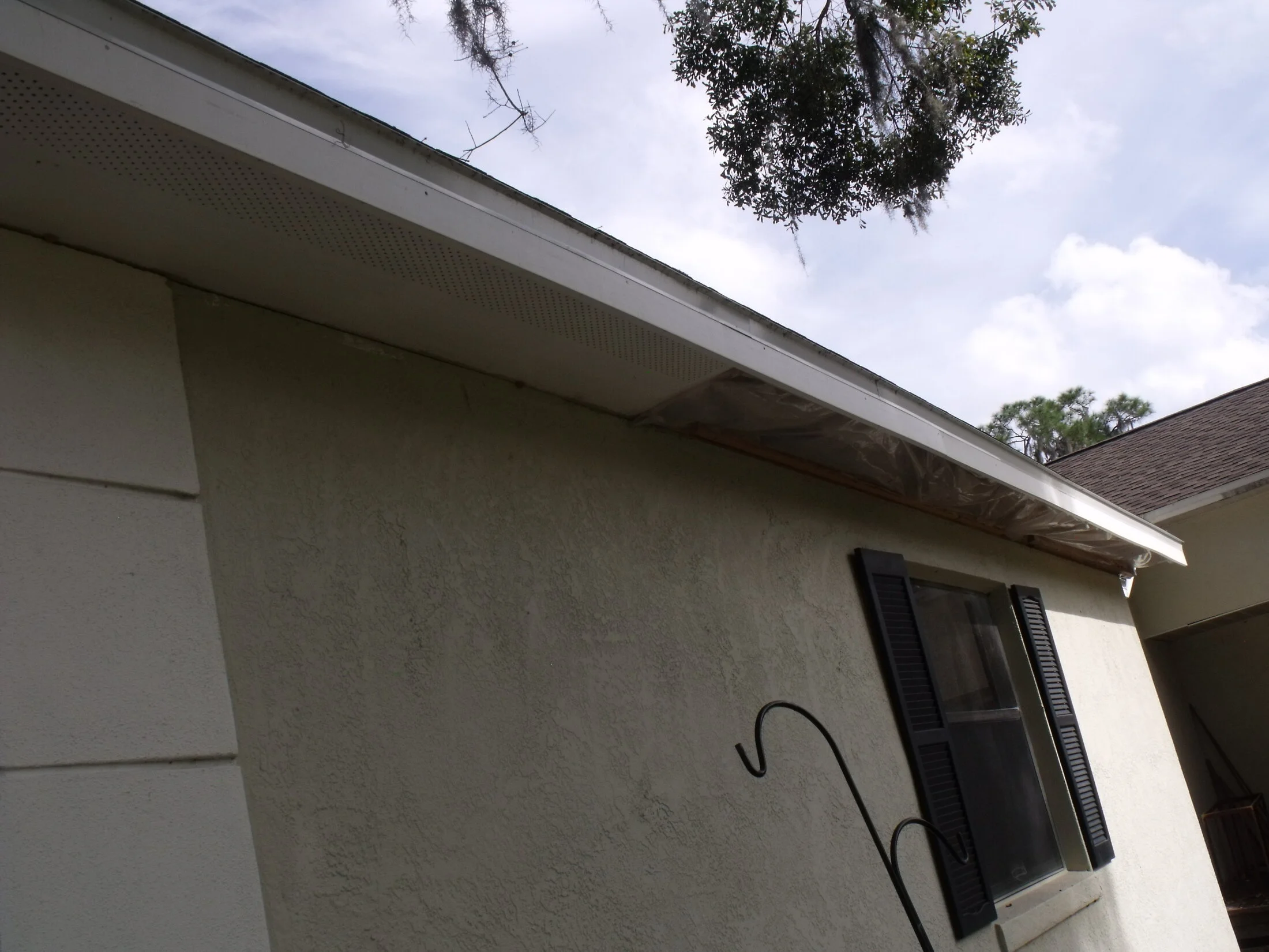

and finishing my soffit upgrade...
