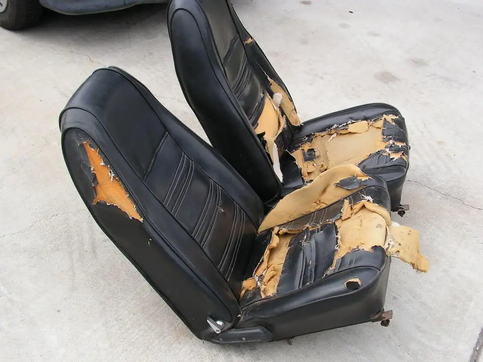

He sent me a picture of the highbacks and they're not in good shape they're pretty cut up and not the right color.

THat seems like a pretty good deal for hi back buckets. You can even get pony set covers for them...
You can have the frames fixed, but you would have to strip the upholstry, and if you have to do that, might as well reupholster the hi back buckets...
