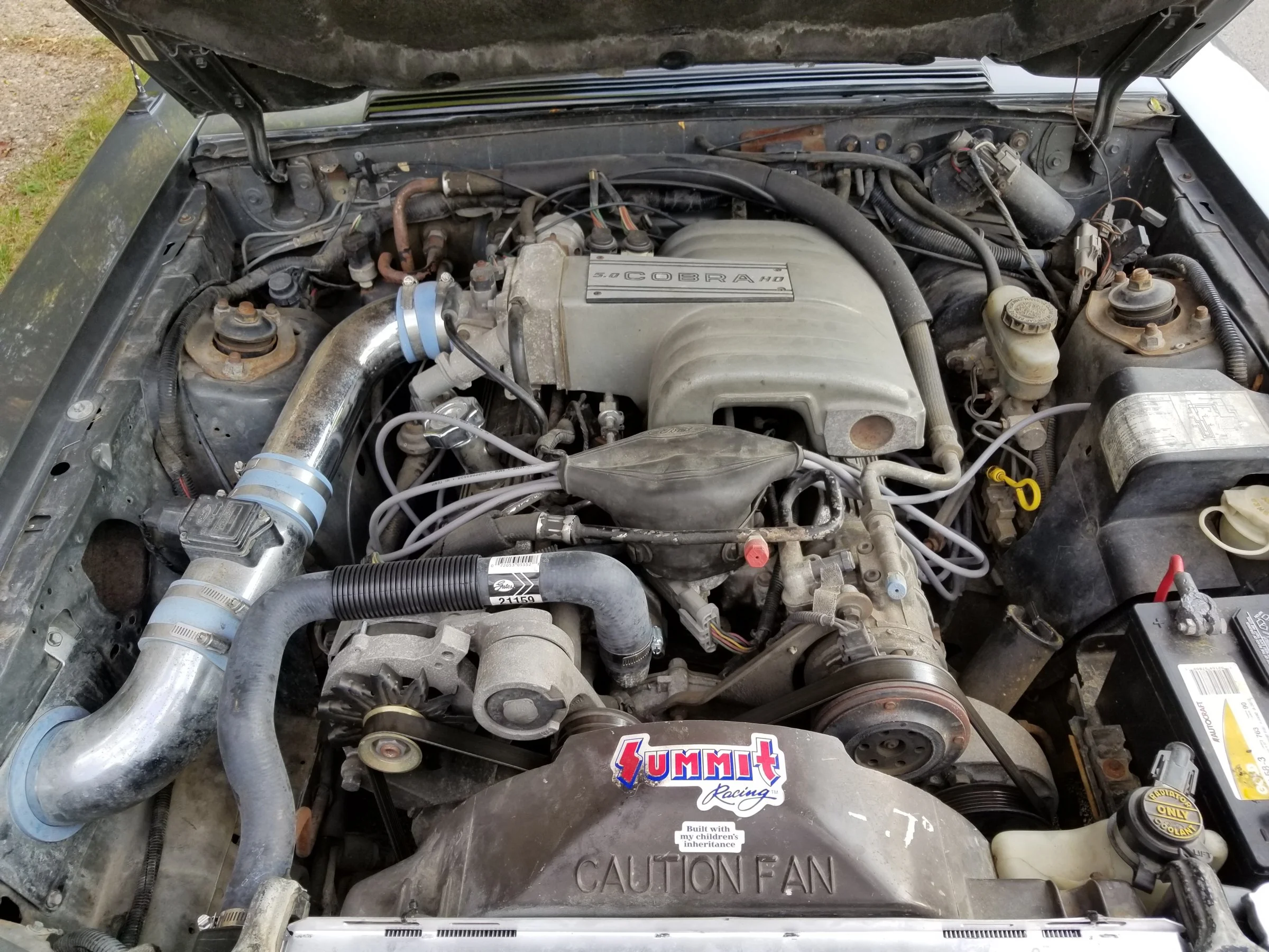

lol...budweiser....completely stock engine as far as i know...bought it a month ago...150,000...engine is stock...flowmasters, aftermrket mass flow sensor...1993...thats about it...it bought it cause i wanted it.....didnt ask much questions...ughhh
..dumb, i l know
I see it has a CAI. Do you know if the MAF meter is calibrated for the CAI? If not that could be your problem. If you have the stock air box it would be worth putting it back on for testing.
