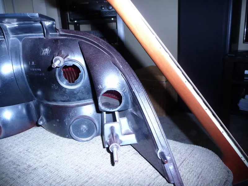

I have both 94-95 and 98 taillights, so to make the sequentials work on the 94-95 lights, I had to cut off the outside bulb and socket and replace it with a 3157 socket. And I had cut out the opening on the back of the taillight where outside bulb goes...see pic. They then sequence from inside to outside just like 96 and up Mustangs
Do you by chance have a video of that?
