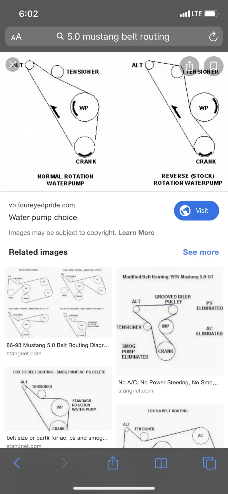

Hey guys I tried to take a look and couldn’t find the length of the belt to delete the smog pump, ac, and power steering. I have found the way to run it but there are no lengths provided for this setup. I’m looking for a rough belt length if nobody has a number that definitely fits.i have attached a picture of the route I’m talking about. I have a stock rotation waterpump. I appreciate the help guys!

I still have mine from when I did that. I believe it's 30.5". I did mine with a stock (reverse rotation) waterpump and a March alternator bracket and turnbuckle. No tensioner. Never a problem.
You’ll have to string it. Unless you find someone with the exact same setup as you, belt lengths will be different. Different pullies or brackets will change all that.
Even better, use one of those tape measure strings tailors use for a suit. Head to local auto parts store, but 3-4 belts and test fit.

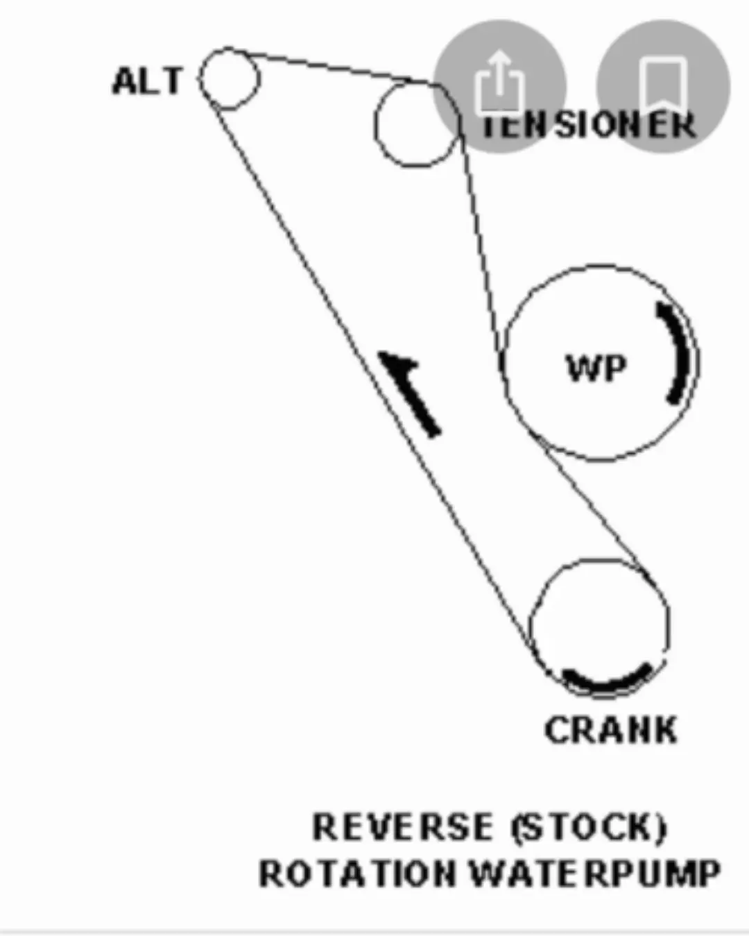

Are you changing to the standard rotation pump setup? Not enough belt wrap on the reverse pump setup in your pic. I would worry about the water pump pulley slipping in that setup, especially at higher RPM
