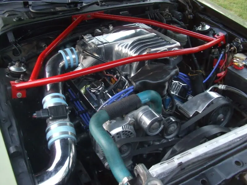

Here it is.....I know I need to do a lot of underhood straightening, but that will come in time....

Thanks Jamee.It'll look better when I get some wires routed and get everything straight and cleaned up like it needs to be.When I got the car from the salvage yard,it was devastating under the hood.
