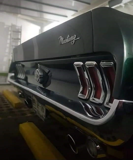

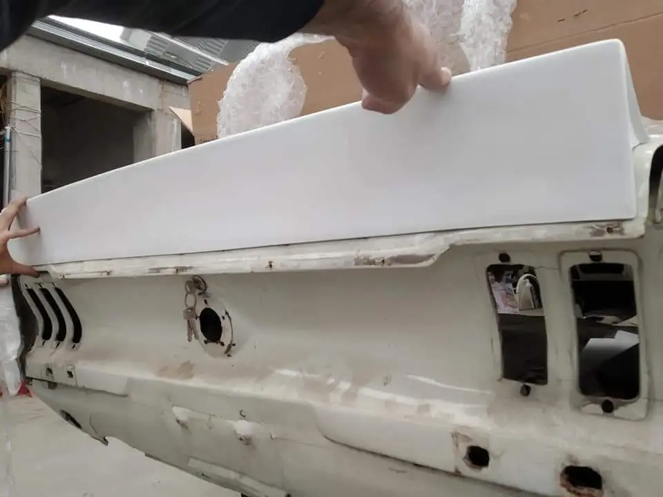

I bought this Shelby spoiler for my Mustang '68 and I need to cut the trunk lid to got a similar result like the green one. I know that is a fiber glass trunk lid with the spoiler included. Somebody did it?
I have a german welder and painter, but I need a reference...Good luck, I hope your a good welder, fabricator. If not dont even try. To pay someone to do this would not be cheap.
Maybe like you said the fiberglass version could be the best one, but if this company sell a spoiler, probably somebody posted a tutorial o something like this...Your best bet is to get a fiberglass lid and sell your original to recoup some cost...its far easier to work fiberglass for what you are wanting to do. I have done a lot of metal work in the course of my restoration but I would hesitate at that task since you would need some way to roll the edge back under after the cut, and while there are tools for that, they are rather specialized and tend to be several hundred dollars on the low end. A bead roller with the correct dies might to the trick.

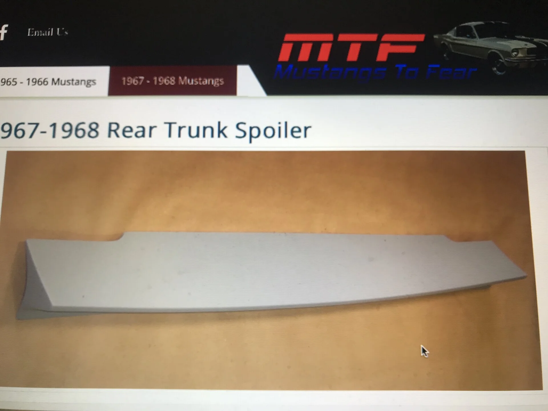

Mustangs to Fear has a 68 Coupe rear spoiler. Note curves
Thanks! If there is not a best option, maybe I am going to buy a fiberglass lid, But I want to find somebody that install this spoiler.If that is a fiberglass spoiler it is meant to be bonded on . Fiberglass and metal really do not mix well though ,they expand at different rates and will eventually crack . Your best bet is a full fiberglass trunk lid .
I actually work with fiberglass daily ,it will crack or show a attachment line sooner or later ruining a paint job

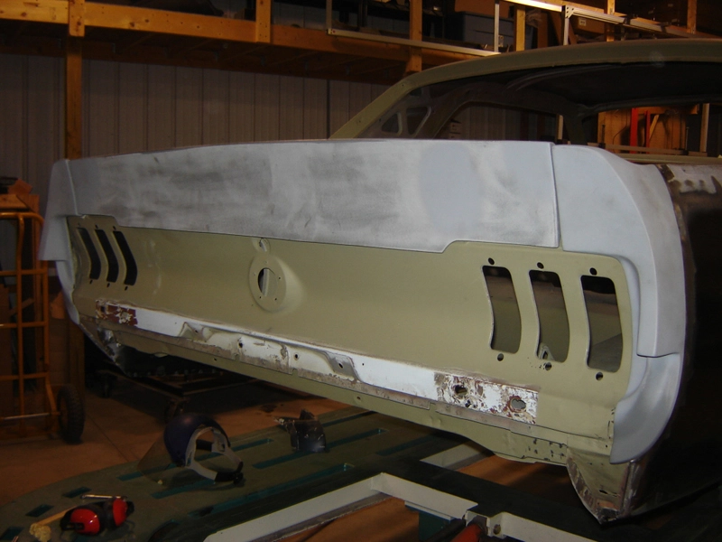

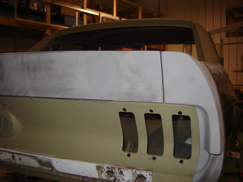

My Homemade GT/CS Steel Decklid
My GT/CS tribute I am building came with a new uninstalled fiberglass decklid and endcaps when I bought the unfinished project. I'm not impressed how most of these seem to fit and this was no exception, so I had a brand new steel decklid that fit great so I decided to build my own. As I am...www.vintage-mustang.com
