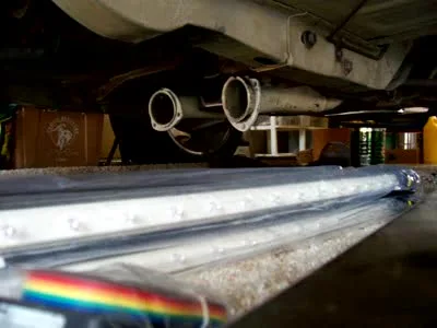

Well it's been about II years since I've had the Cobra on the road. Over this past winter I made a few change to the factory 302 engine with 41K on the bottom end. Here's the list; 8-qt oil pan. hi-vol oil pump and CM shaft, Edelbrock Performer cam, Crane Energizer 1.7 ratio roller rockers, E7TE heads, Edelbrock Performer intake, Holley 600 vac sec carb, and for now open Hooker Super Comp headers.

Another Video from the Headers perspective, Crank It Up!!!!!!!!!!!!!!
