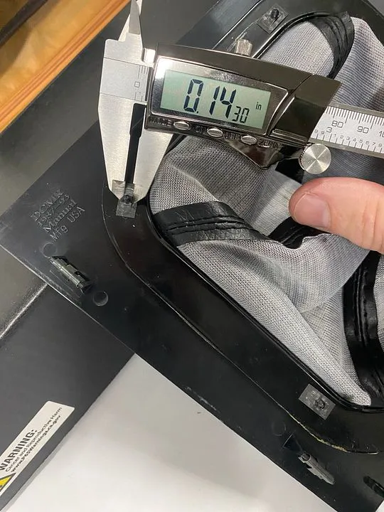

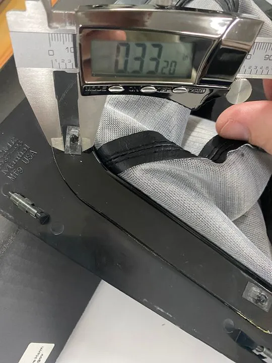

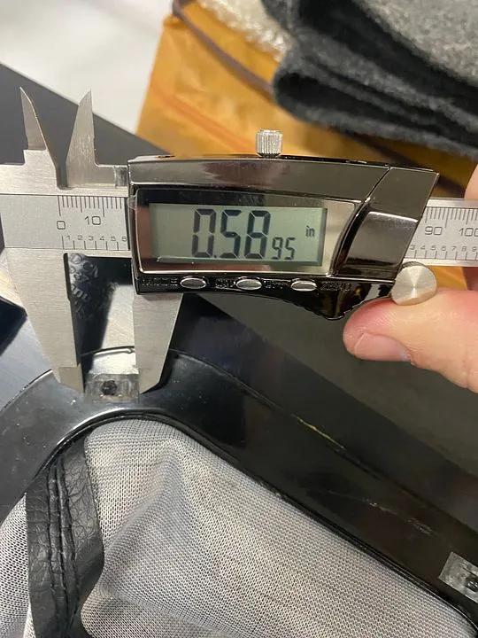

Was putting off putting a new lower shifter boot on so I did that this morning and got you some measurements:
Hope those help. I think I may have hooked the clip when I was checking the stud diameter so I am going to measure that again.
These clips are kinda, but certainly not exactly, close.
Here are the comparative dimensions....

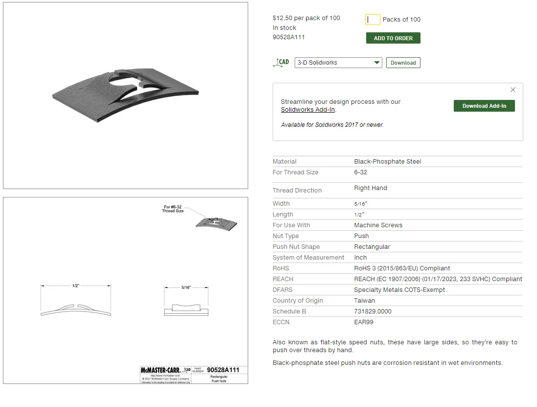

Length - .589 measured vs .50 push nut drawing
Width - .332 measured vs .31 push nut drawing
Mounting Post - .143 measured vs .138 (#6 screw diameter)
McMaster link needs needs a login to see, they push nuts? The round ones. Those would work too. I threw one in my daily just haven't swung by a store yet. If #6 is .138, should be easy to find a few that will work.
That's odd.... it shouldn't need a log-in. Dunno? :shrug:
Yea, they're the rectangular push nuts, very similar to OE ones. The minor differences in outside dimensions shouldn't matter, just don't know for sure about the stud vs mounting "hole" size. Probably would work, I think.
Try just going to the McMaster-Carr website and search for part # 90528A111. See if that works.
Price is cheap enough for 100 pieces, but shipping will increase the price 1-1/2 or 2 times maybe. Still be cheap for 100 pcs tho, imo,..... but now you got 96 extras! You may be able to find some locally where you wouldn't have to buy a quantity of them tho. My local Ace Hardware has a really wide selection of all sorts of misc hardware.
