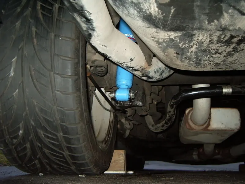

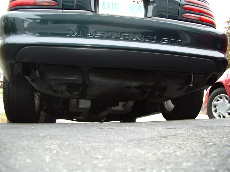

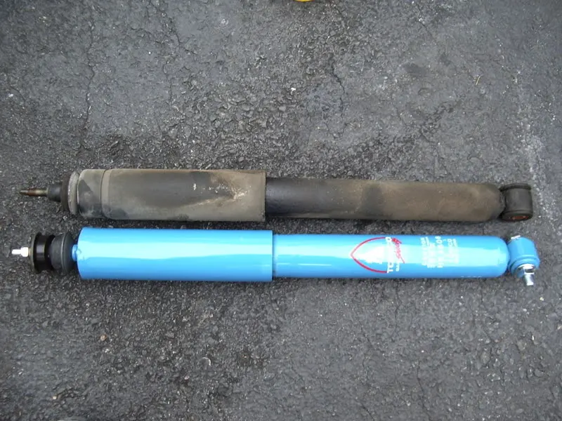

A few pics:
The amount of room I had to work with (not as bad as it looks):
Stock, busted-ass shock next to the new Tokicos. I got the ones for the Fox cars (pn 3608) because my car is lowered 2" and I was under the impression the fox ones were made shorter. I don't see the difference:
Installed, 1.5 hours later:
