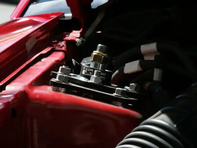

DTN,
This is my car, you should have something like this, I have Eibach Sportlines, Illumina 5-ways and as you see MM CC plates. As everyone said..check spacers.
I have a 2002 GT, our cars use the Fox-length struts up front, heres a pic of mine so you can check part numbers

the shinny things underneath the nut are the spacers that are on the strut the ones for the front should have come with those to mix and match to get them for the correct heightin your case for a 2" drop arrow pointing to what im talking about
The big rubber piece is a "bump stop". That's what I was thinking... do your struts require no bump stops (like my Bilsteins require NO bump stops) and you must have put the stock ones back on... (Bilsteins have internal bump stops)
When I swapped stock struts for Bilstein stuts... the rubber bump stops did not go back on... I thought I had pictures but I can't find them at the moment.
