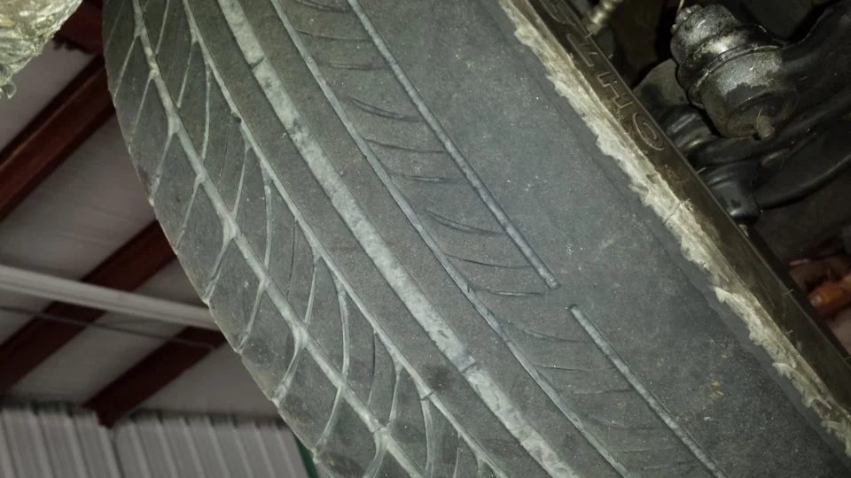

The only shop in town that can do an alignment on my 65 is telling me I need adjustable strut rods to get my caster (which i know and understand) right. But My tires have less than 3k miles on them and they're almost ruined on the inside shoulder from wear from excessive negative camber. I gave the shop the daze cars Shelby drop alignment spec which should have been 0, -.5 of negative camber. I showed them the wear on my tires and he's blaming it on me not having adjustable strut rods and him needing that to get it right. To me that sounds crazy. I'm sure he tried to get the caster as far as he could with the shims but the camber is crazy. What do you guys think. Just shim it myself or strut rods needed or did he half ass it hoping I'd buy his expensive parts that he seems to be pushing? My passenger side uca have no shims and my driver side uca have around 1/4-1/2" or so of shims each.

Take it to a place known for aligning trucks they'll know how to get it done right and won't be afraid of shims. That alignment looks ridiculous. Caster also doesn't cause tire wear. Camber and toe do.

Thanks for the reassurance I figured he was full of it. I asked him to explain to me how caster would affect the camber and he didn't answer me. I called a few shops around my area and they all seemed to have no idea about the alignment. At least not within a reasonable price range and at the risk of getting the same trash results I may be better off investing in the cheaper home alignment gear.

But he said he wasn't able to set everything like the paper said, do to me not buying the $450 adjustable arms. Being my first alignment after the Shelby drop I thought maybe the extreme negative was normal. Took me a little to long to realize it wasn't. I already added a .015 shim all around but I have no idea what the ideal amount of shimming I should be doing. Other than eyeballing it.

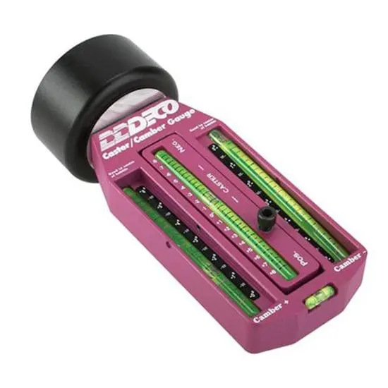

The shop we use to have our mustangs aligned locally told me i was dead on on one side and just slightly off on the other .it only took them a few minutes to correct it and he couldn't believe i did it this way . Summit has a nice magnetic camber caster gauge that sets on the end of the hub with the dust cup removed ,i want to get one .
